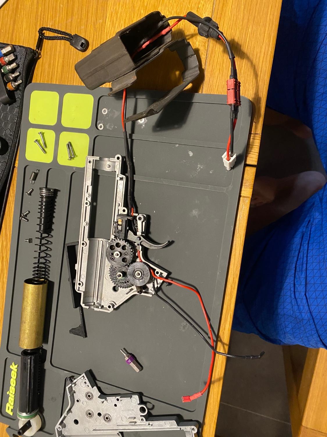

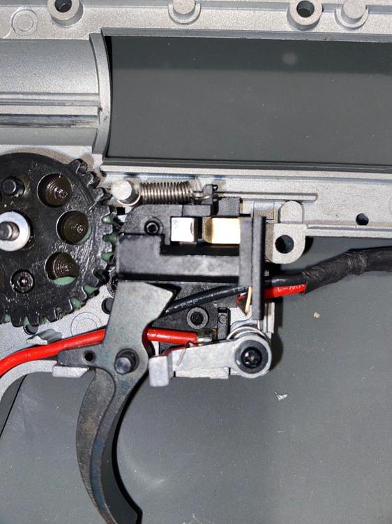

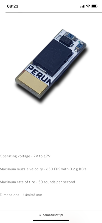

Rogers84 Posted July 22, 2023 Author Posted July 22, 2023 I’ve heard that G&G MOSFET are not great so just ordered a Perun is it an easy fit, anyone got pics or a video of how to install?
Colin Allen Posted July 22, 2023 Posted July 22, 2023 (edited) https://perunairsoft.pl/mosfetmanual.pdf However, i would probably have gone for something like the Perun AB++; it gives you active braking, burst control and precocking and is installed in the same way. Edited July 22, 2023 by Colin Allen Rogers84 1
Rogers84 Posted July 22, 2023 Author Posted July 22, 2023 8 hours ago, Colin Allen said: https://perunairsoft.pl/mosfetmanual.pdf However, i would probably have gone for something like the Perun AB++; it gives you active braking, burst control and precocking and is installed in the same way. Many thanks any assistance on where to put it the battery goes in the the second mag, sorry if it’s stupid question 1st time upgrading
Colin Allen Posted July 22, 2023 Posted July 22, 2023 3 hours ago, Rogers84 said: Many thanks any assistance on where to put it the battery goes in the the second mag, sorry if it’s stupid question 1st time upgrading As shown in the manual, you need to connect both red wires (the one to the battery and the one to the motor) to the same terminal on the trigger unit, with the signal wire going to the other terminal. It is probably best to put the mosfet in the dummy mag, soldering the wires to it as shown in the manual. Rogers84 1
