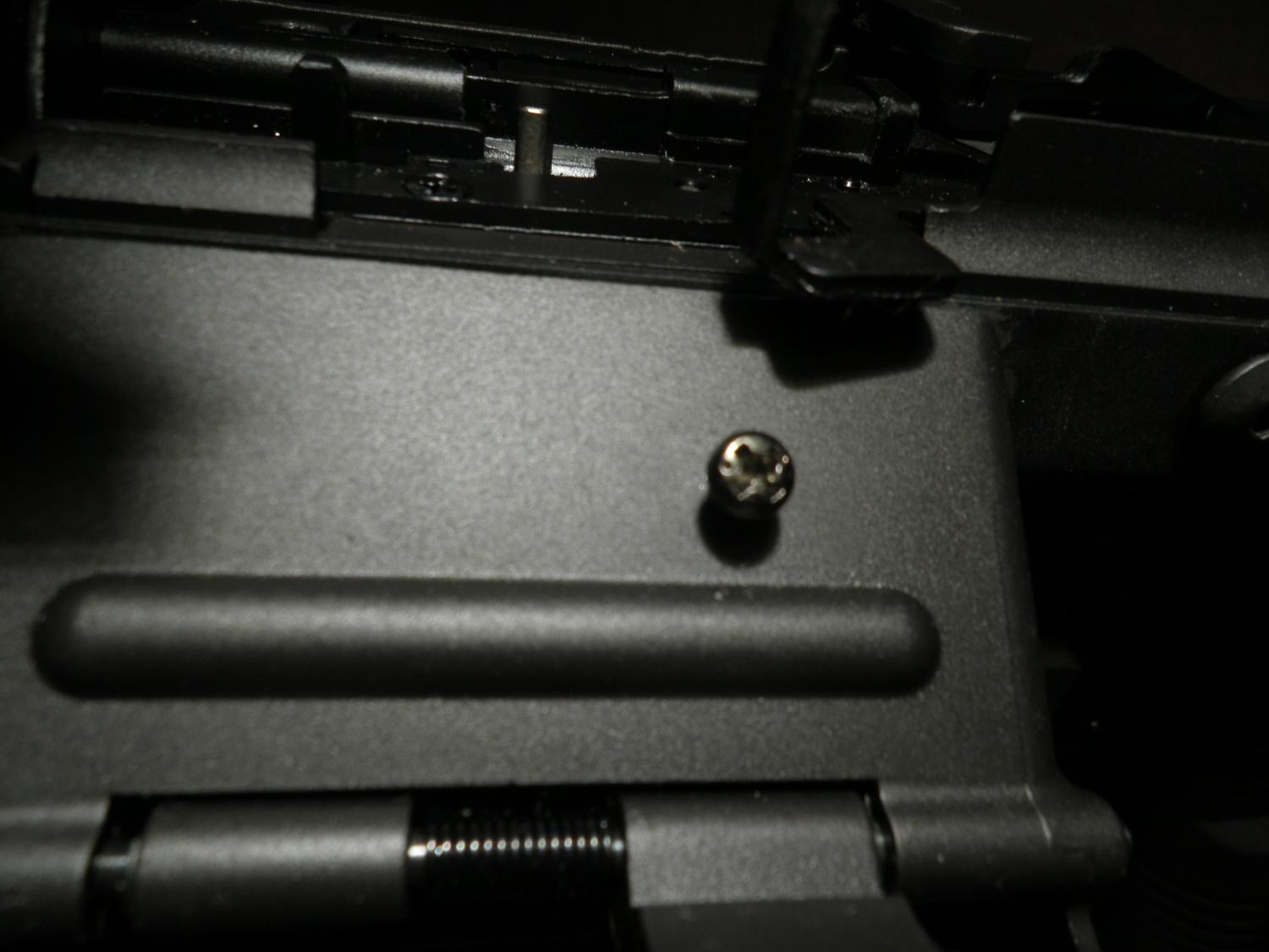

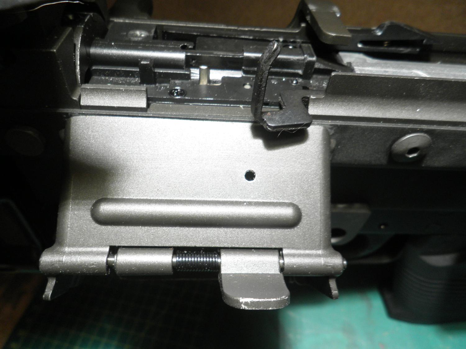

Nick G Posted October 28, 2023 Author Posted October 28, 2023 5 minutes ago, Spartan09 said: i was debating fitting a real bullet belt, but im worried that its extra weight may cause further issues with the box mag gas connector popping out, or break the "wiggler" do you have pics of this mod? i may need to do the same to mine, but i am also reluctant to do anything too invasive where abouts are you playing? Playing at Survival combat games in North Devon , my usual site. I'll grab a picture of the mod after the rugby. It cant be seen once the feed plate is back down.
Nick G Posted October 28, 2023 Author Posted October 28, 2023 Hole drilled and tapped for a M3 bolt M3 screw/bolt fitted . It's about a 5mm long one from my R/C spares box. I've drilled the mag well so that the bolt presses down on the mag catch pretty much right over the 'wedge' that secures the mag. And belt feed tray cliped back down. Completely hides the mod, I don't bother to bolt the tray back down and never had an issue. I'm sure something else could be tried, but this works on mine, was quick and easy to do and importantly doesn't show . Just put the box mag block in, pop the bolt in and screw down untill it's starting to go tight, doesn't need to be over tightened which just risks stripping the thread. Only needs to prevent the mag catch from moving . 1st commando and gavinkempsell 1 1

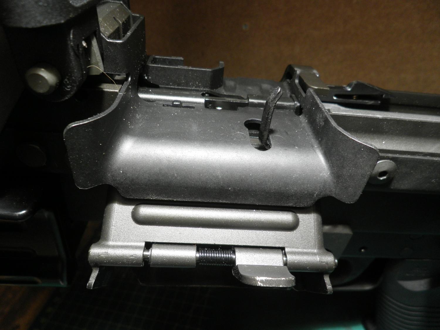

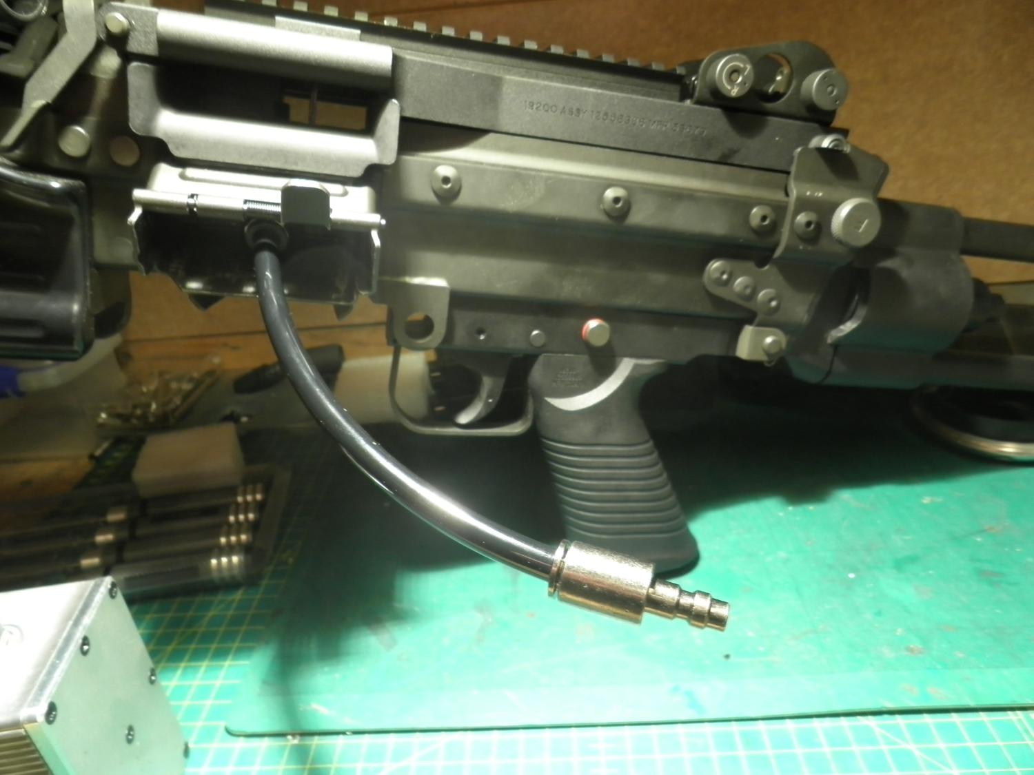

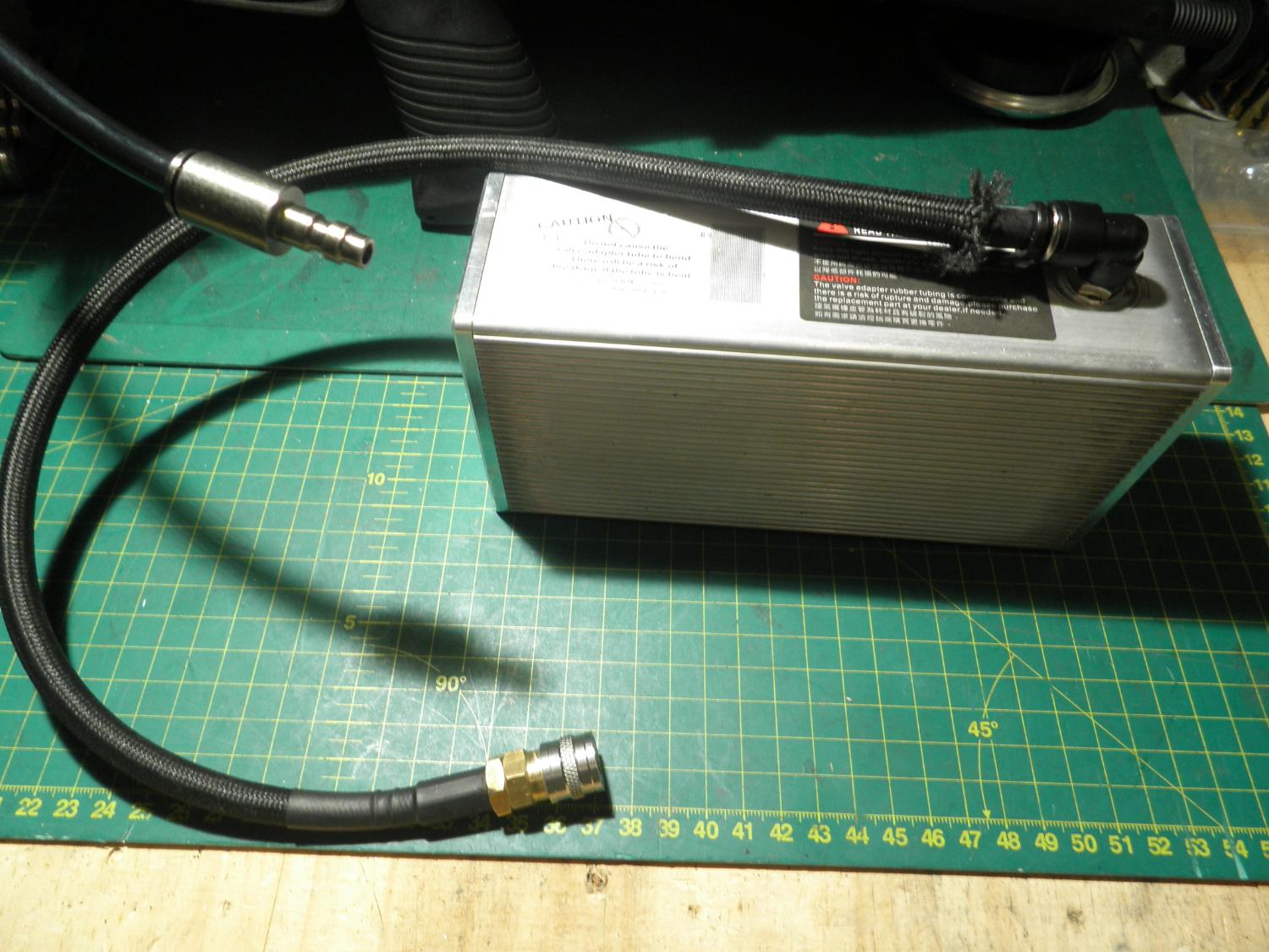

Nick G Posted November 30, 2023 Author Posted November 30, 2023 Thought I'd experiment a bit with the gas feed from the box mag to see if I can make something totally secure and non invasive. Picked up the Airtac hpa kit, now I would only hpa it if I can get a bottle in the box mag and I wouldn't use the mag adapter which allows you to run an aeg box mag. The limited ammo and mag changes are part of the GBB experience for me. Very much at the proof of concept stage, but I've fitted the hpa adapter to the gun, just replaces the brass fitting in the mag well , and run part of the line that comes in the kit. On the mag I've used an hpa line I had knocking about which I cut in half , the rubber tobe pushes straight in to the fitting on the mag tank. I now have a QD fitting with a stop valve. The tank is holding gas fine. A quick test looks promising. The gun cycles fine, and that's with only a short fill and it's bloody cold in the garage . I'll do some testing at weekend and shorten the lines , may use the spare rubber section for the line in the gun as it's more flexible, so easier to route into the box mag. I wont be able to run it from the STANAG, but tbh I dont see that as an issue. If this works, it's totally reversable in about 15 minutes. I'll keep you all posted Spartan09 1
Nick G Posted February 7, 2024 Author Posted February 7, 2024 Experiments with the QD fittings continue. But with mixed success , so for the moment I'm running it stock but have my eye out for a very compact gas bottle that would fit into a box mag. I have however fitted the DNA steel mag catch . It does feelmore robust than the stock one, and it also seems to have stopped the box mag gas block jumping loose. I can only think the 'lump' on the DNA catch might be more pronounced. I have yet to try it in a game though so we will see. When I play next I'll try it without the m3 screw that I normally fit to the mag well and see what happens. Still loving the 249, it's so much fun !
Nick G Posted February 11, 2024 Author Posted February 11, 2024 Spent some time testing the mag catch today as I wont get to play untill next month. 2 full BB loads (about 120 per mag) through it with the box mag and no sign of the gas block popping out , where as before you'd get half a dzen shots before it jumped out. Seems to be sorted by the new mag catch. gavinkempsell and Spartan09 2
