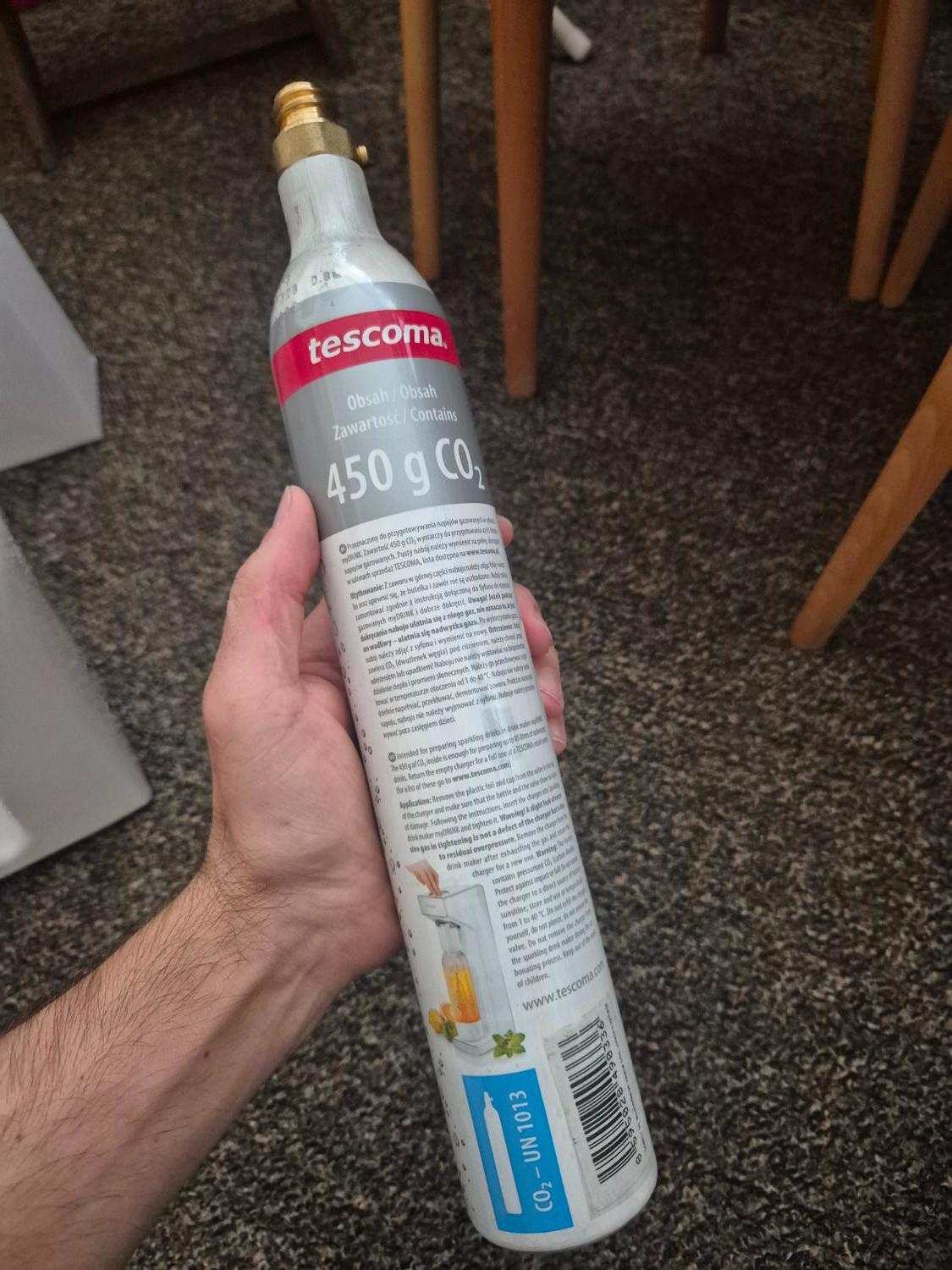

Anonymoose Posted July 20 Posted July 20 48 minutes ago, Nick G said: I've ordered the railed hand guard for it too to change the look a bit. I bought a Midwest Industries for my A&K 249. Beautifully made piece. Unfortunately not a direct fit though. Found a suitable CO2 cylinder for you guys with the VFC: Nick G and Lyndication 2

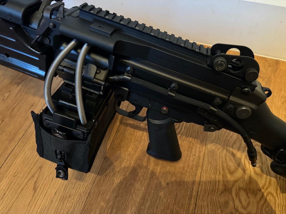

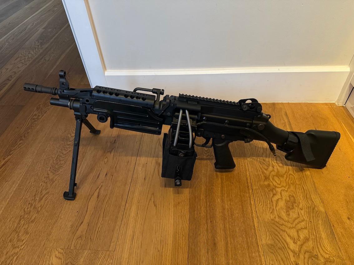

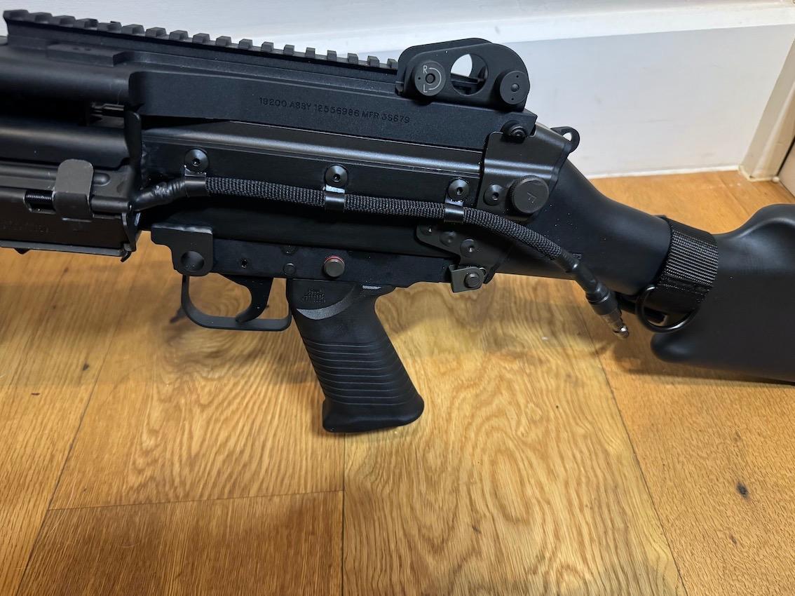

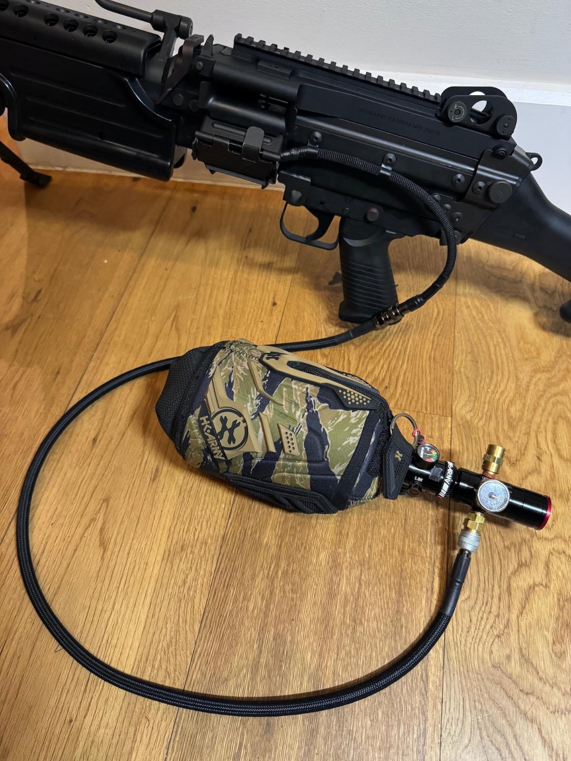

Zooankski Posted September 15 Posted September 15 On 03/09/2025 at 12:29, Zooankski said: Hi all. Picked up a new M249 yesterday and have an issue. The trigger sear appears to be hit and miss, sometimes not releasing the bolt. Tried lubricating everything and the issue persists. You can see the bolt move very sightly and nothing? Any thoughts? IMG_8857.mp4 All sorted! Sear was binding on the bolt and you could see marks. Little bit od 800 wet and dry and some autosol has cured the issue! Now this is fun! HPA set up completed (almost as waiting on larger clips to allow box mag wiring to run with line too). Came out pretty well I think and zero issues. Nick G 1

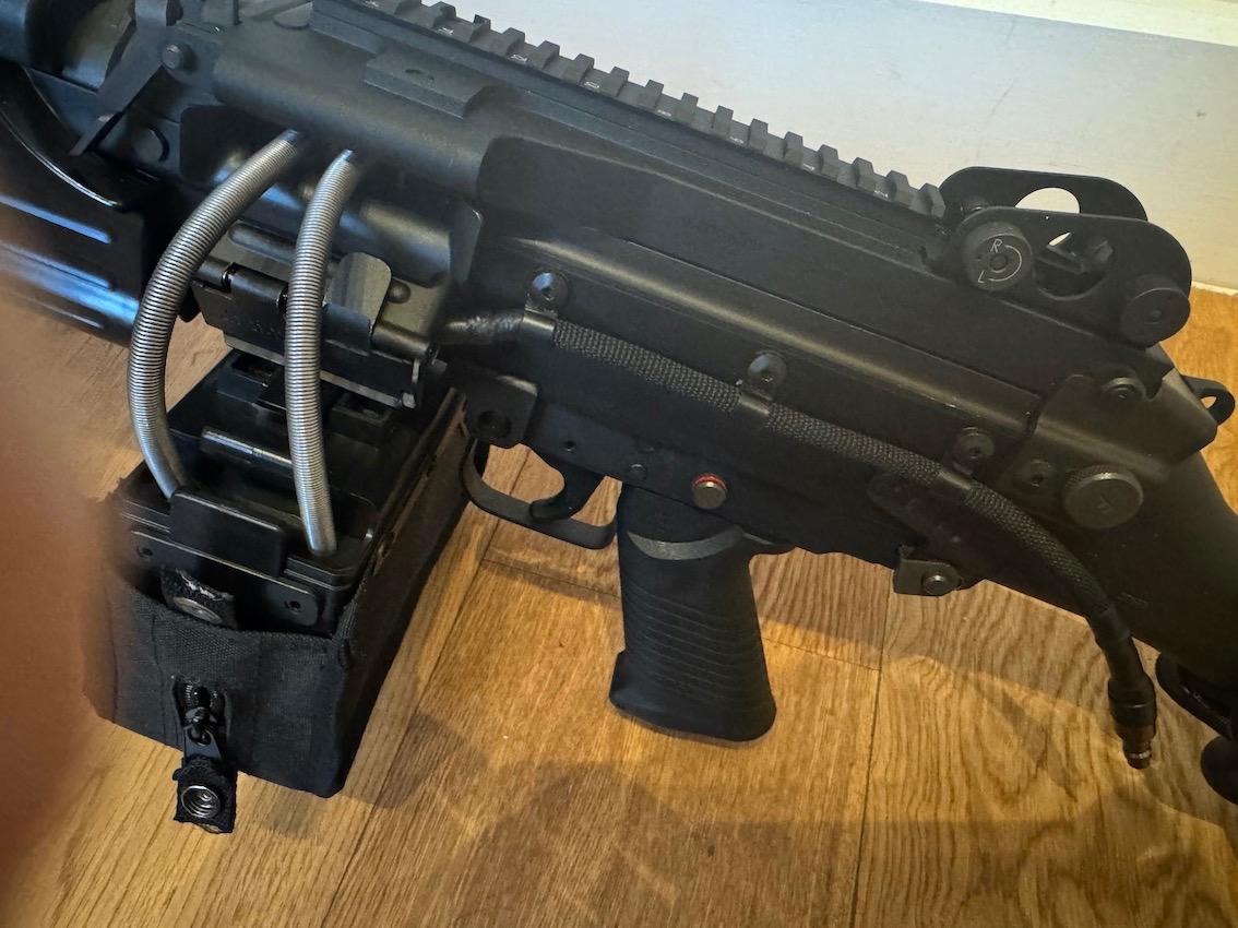

Zooankski Posted September 17 Posted September 17 (edited) Never had a line catch tbh and run 2 MTW's also so it just made sense to go this way. Just takes careful planning and routing of the line on your kit. Mine comes from a sack on the rear of my plate carrier, over the shoulder (all through Molly tabs) and down the front. This leaves a loop tucked close in to the body and works well, even in a prone position. I did add 0ne more line support clip to the third internal rail support screw to the set up but no other changes. Next issue is how to fix my bullet belt over the box mag feed and mic springs 😀 I was going to add a microswitch to the trigger but the mic works perfectly for now routed in the spring, as I suspect the metal amplifies the sound. I meant to add originally that the slightly bunched area as line enters the Maxwell is actually just the heatshrink over some stainless metal braid protecting the line. I Ali blacked the line hole in the mag well which now looks like it was factory and the original mag fits perfectly and operates fine so all removable. Edited September 17 by Zooankski Nick G 1

shatis Posted October 21 Posted October 21 On 17/09/2025 at 08:43, Zooankski said: Never had a line catch tbh and run 2 MTW's also so it just made sense to go this way. Just takes careful planning and routing of the line on your kit. Mine comes from a sack on the rear of my plate carrier, over the shoulder (all through Molly tabs) and down the front. This leaves a loop tucked close in to the body and works well, even in a prone position. I did add 0ne more line support clip to the third internal rail support screw to the set up but no other changes. Next issue is how to fix my bullet belt over the box mag feed and mic springs 😀 I was going to add a microswitch to the trigger but the mic works perfectly for now routed in the spring, as I suspect the metal amplifies the sound. I meant to add originally that the slightly bunched area as line enters the Maxwell is actually just the heatshrink over some stainless metal braid protecting the line. I Ali blacked the line hole in the mag well which now looks like it was factory and the original mag fits perfectly and operates fine so all removable. Hey bro how did you get that a and k mag to fit?
Zooankski Posted October 22 Posted October 22 It is a Raven evolution mag and I just sanded and filed down the mag to fit mate. shatis 1
