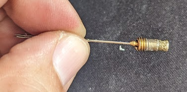

This meant I could see what the fill valve looks like from inside the mag:
Sorry for the shit focus.   The gouge marks on the barrel of the valve are my first attempts to undo from inside with a pair of needle-nose pliers.   I can see it's moving, but the tiny room I have to work in means I can shift it about a twentieth of a turn at a time.   This will be painfully slow work!   I might pop out and buy some more svelte pliers in the hope I can turn it a bit more on each go, but really I need a more cunning method of unwinding it!

I had a cunning thought based on the word 'needle' - I found a thick needle and pushed / hammered it into the external valve hole - and it gripped enough to let me spin it with no effort whatsoever :D
Yay!
I've succesfully done the same with a drill in the past, bit dug into the remaining bit and spen it straight out.
Well sorted Mate, all part of the GBBR fun !
