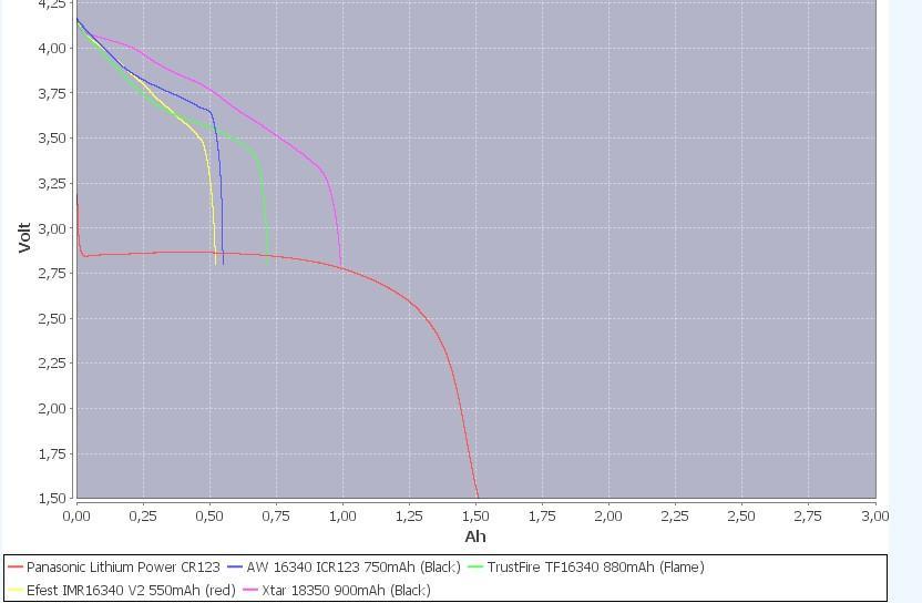

I have issues with getting the NGAL to run. The laser is really nice and bright at first, but it only takes it like 1 minute to drop until it's barely daylight visible. It stays that way until I put in a new battery. I'm using rechargeable batteries, am I supposed to use regular ones? Or am I missing something?

Well RCR123A rechargeable lithium battery. I know nothing about electonics so I'm not sure what this graph is saying but I assume rechargeable batteries, at least of the type I'm using, are not the best
