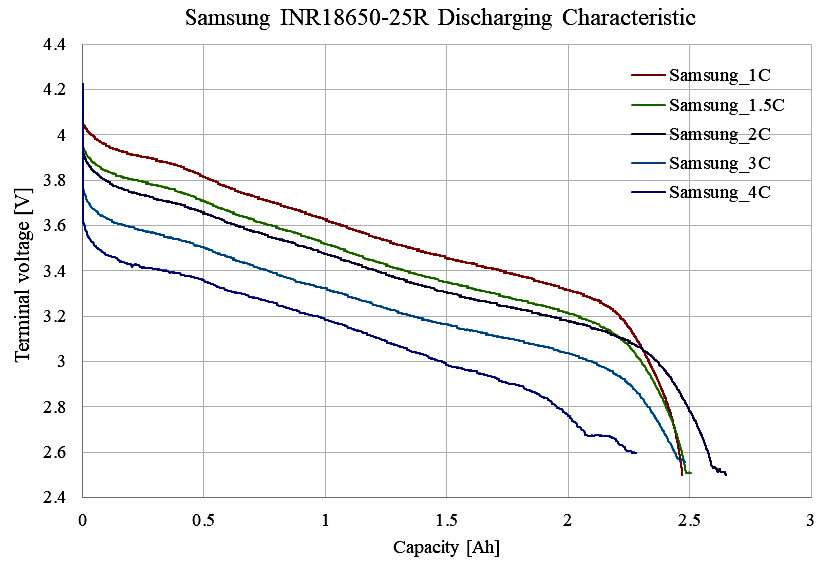

Supporters Lozart Posted November 15, 2023 Supporters Posted November 15, 2023 48 minutes ago, Sewdhull said: but you will get more mAh at lower currents That's not true. The mAh capacity of the battery is not affected by the discharge rate. A 2000mAh battery is a 2000mAh battery regardless of if you drain it at 2mA or 2A, it will discharge for longer at a lower current but the overall capacity remains the same. Cell discharge rate is affected by chemistry and quality of manufacture, that is true. LiPo batteries can discharge at much higher currents than Li-Ion for example, but will sag more under load. And yes, a cheap shit battery will always perform poorly compared to a high quality one (although given the spectrum of quality in airsoft batteries that is pretty much moot because they all suck balls to some degree). The actual numbers DO matter if you're trying to make sure that the battery you want will meet your needs. For example if you have limited battery space and can only fit a physically small battery in then it makes sense to go for the highest quality you can afford so that you get the best performance from that physical size. If size is not a restriction then yes, go nuts - as long as the current capability of the battery meets or exceeds your demand then you'll be golden.
Pseudotectonic Posted November 15, 2023 Posted November 15, 2023 6 hours ago, Lozart said: That's not true. Ackchually that is true, for example:
Dan Robinson Posted November 15, 2023 Posted November 15, 2023 Is there more context to the chart? I'm minded to think that with that kind of voltage drop temperature is playing a part due to pulling too much from the battery. Happy to learn though.
Pseudotectonic Posted November 16, 2023 Posted November 16, 2023 That was just a generic LiPo discharge curve from https://www.dnkpower.com/lithium-polymer-battery-guide/ You will get less overall mAh regardless of temperature with bigger current, as well as a bigger voltage sag the entire way So in any case, bigger capacity battery is always bigger because it represents a smaller C at any given current and will have less voltage sag, which is really what can affect the feel of the motor
Supporters Lozart Posted November 16, 2023 Supporters Posted November 16, 2023 14 hours ago, Pseudotectonic said: Ackchually that is true, for example: If you extrapolate the trace down to zero, they all converge.
Colin Allen Posted November 16, 2023 Posted November 16, 2023 2 hours ago, Lozart said: If you extrapolate the trace down to zero, they all converge. Indeed they do; the mAh rating is a measure of capacity, which does not change based on the discharge rate. Lozart 1
Sewdhull Posted November 16, 2023 Author Posted November 16, 2023 You cant extrapolate to zero, only to the useful voltage for your application. At just 4C you've lost 10% of your capacity. In Airsoft 3v is probably the lower useful voltage as your motor will slow down. Running a power bank for example, the electronics will produce the required voltage as long as the battery can supply current, well to a point. Running a lithium battery to low voltages will damage it long term too. 1 hour ago, Colin Allen said: Indeed they do; the mAh rating is a measure of capacity, which does not change based on the discharge rate. There are losses in discharging a battery, those losses increase with current based on the IR of the battery. Capacity is quoted at specific discharge rates because of this. Perhaps not in Airsoft however, but at a cell level you need this information to make a pack for whatever your application is.
