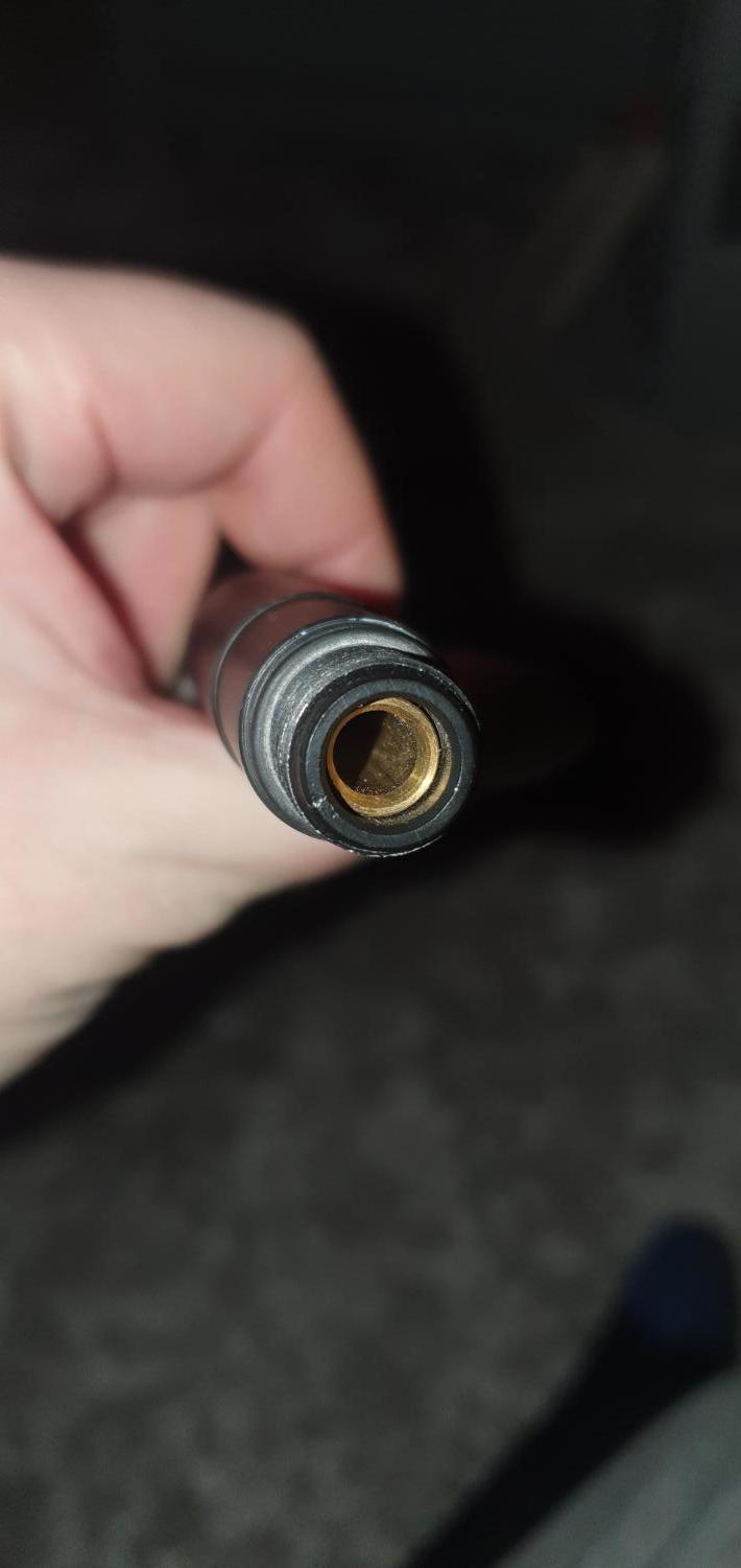

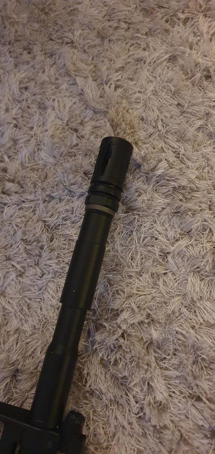

Caj109 Posted December 29, 2023 Posted December 29, 2023 (edited) Hello, Just took my hop unit and inner barrel out to measure as different lengths on Google for my gun. Seems its measuring about 380mm. As im looking to upgrade the barrel as gonna change the bucking too, Should I keep the same length or go for 363mm? Seems the current inner barrel reaches to the end of the outer barrel then it has a flash hider on the end currently. Gun is an Specna Arms SA-E03 Thanks Edited December 29, 2023 by Caj109
Sewdhull Posted December 29, 2023 Posted December 29, 2023 Are you looking to lose BB energy for any reason? If not keep the same length.
Caj109 Posted December 29, 2023 Author Posted December 29, 2023 (edited) 32 minutes ago, Sewdhull said: Are you looking to lose BB energy for any reason? If not keep the same length. Nope just wasn't sure if the length is essential, but makes sense to keep the same length. Thanks I'll try get hold of a 380mm barrel Edited December 29, 2023 by Caj109
