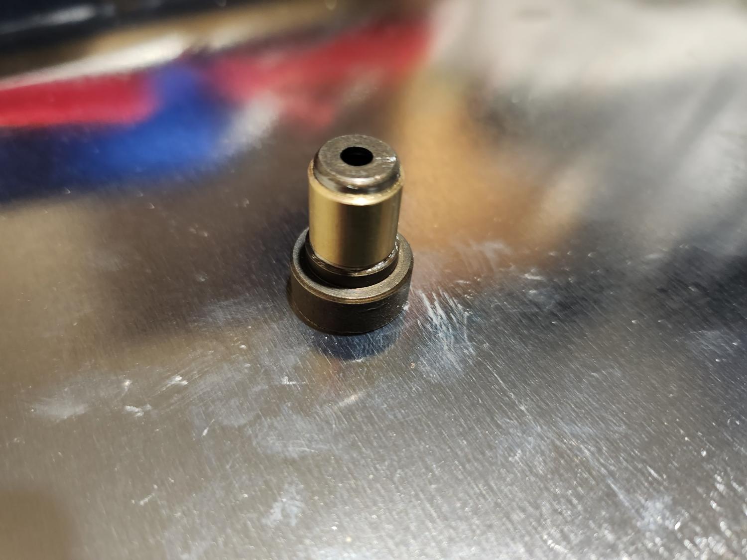

Sewdhull Posted January 1, 2024 Posted January 1, 2024 I thought everyone would make it so thier motor stayed in one place whilst in use. Seems pointless shimming your gears and then let your pinion flail about as it rides the bevel because the motor isn't fixed to anything or slotted snugly into anything. Some might be lucky with tower gearbox fit ment. I had a mil play. I used .5mm wall brass tube as a shim. 57 minutes ago, Rogerborg said:

Pseudotectonic Posted January 1, 2024 Author Posted January 1, 2024 2 hours ago, Sewdhull said: .5mm wall brass tube Nice, you cut it yourself? Does it free float or glued down? 1 hour ago, Adolf Hamster said: adjust motor height Yes it should have a little play for free movement, a bit like shimming other gears
Sewdhull Posted January 1, 2024 Posted January 1, 2024 2 hours ago, Pseudotectonic said: Nice, you cut it yourself? Does it free float or glued down? Yes it should have a little play for free movement, a bit like shimming other gears Yes, for this type of thing on thin tube I'll use a drill to hold the tube and a file to cut the tube itself, just put it on the tube in the right spot, let it make groove and then file it as the tube revolves. Once you have a decent groove you can use a sawblade, then back to the file to finish it off. Deburr and it's ready. I make it an interference fit, heat the tube and drop it on. If the tube has a bigger OD than needed, reduce that with wet and dry in a spinning drill before cutting. This one didn't need it. Or you can ream the opening to fit the tube, a 10mm reamer works but all this depends on how much gap you have to start with. A bearing in the thin end would be nice but this tower doesn't have one. The tolerances for some parts are really poor I have found in Airsoft. Pseudotectonic 1
Pseudotectonic Posted January 1, 2024 Author Posted January 1, 2024 Wow that is labour and skill intensive but certainly a much nicer result than tape

Sewdhull Posted January 1, 2024 Posted January 1, 2024 2 hours ago, Pseudotectonic said: Wow that is labour and skill intensive but certainly a much nicer result than tape It's just 10mins to cut and prep the tube, it's half a mil wall thickness. Can't use a pipe cutter cos the cut piece is too short.
