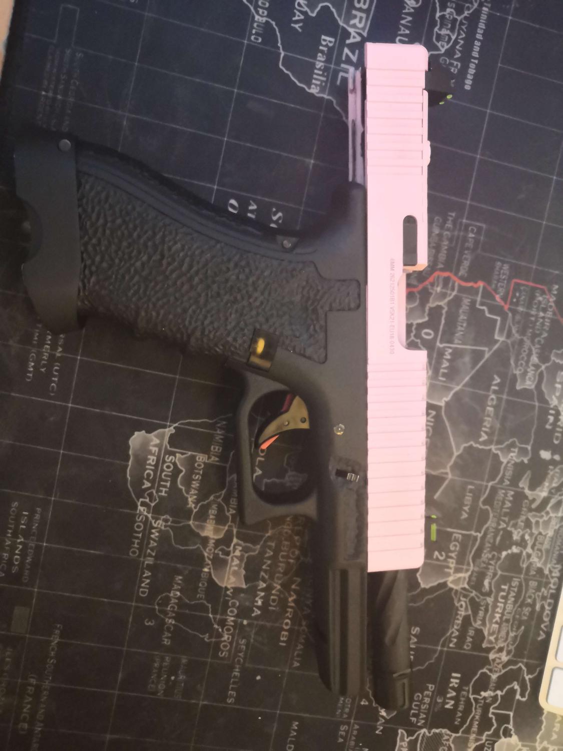

Hey all!

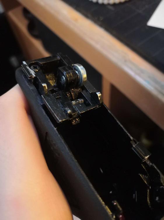

I recently purchased a Vorsk EU18 and it was working perfectly for a good while, just testing out on some targets in my back garden. However in my ever hungry quest for knowledge and general curiosity I disassembled the top slide and took out the hop-up, recoil spring and inner barrel. Upon reassembly I started encountering this issue where the slide will not return to normal position unless I use a screwdriver to manually push down the hammer disconnector (I think thats the name) from within the ejection port as it seems to always catch on the slide. I've included pics of the hammer catching on the slide as well as the hammer mechinism in the cocked and uncocked state.
I really want to get this fixed soon but If I have to send it back to PatrolBase (Where I bought it from) to get it repaired then that would be a real pain in the arse.

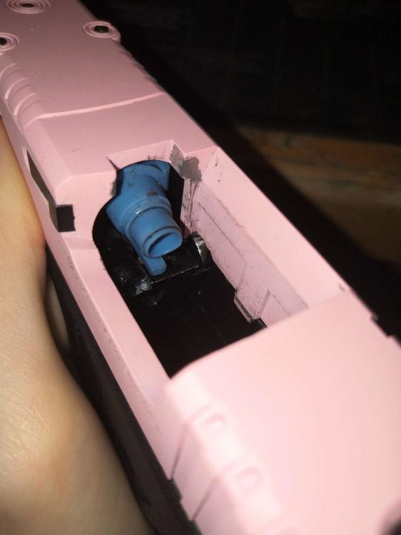

I'm based in Cambridge. As you stated, I only disassembled it for a quick hop up adjustment and some cleaning of some of the components, now this happens every single time I pull the slide back or when it fires, requiring me to push down the disconnector every single time. I only had it for a day before it started doing this. Here is a picture of the inside of the upper as well as the problem I'm experiencing.

If you have a small file try to make the area circled a smooth ramp
Your first pic shows the metal sticky up bit (msub) alongside the slide when it should be under it.
Either the metal parts holding the msub have moved, the slide is not on right, or really loose. I cant see the msub bending unless the metal parts at the rear have moved, it looks good from here.
Check the slide with no mag in there. It's hard to convey how it should be
Also I don't think the slide should go that far back so look at the inner and outer barrel alignment
Have you had the metal parts at the back out?
Check the msub isn't bent too

I didn't remove the metal parts at the back no, just the innerbarrel/hopup and the recoil spring.
I could honestly try but I wouldn't want to cause any irreperable damage if the fix you suggested doesn't work. Thankfully there is a shop just outside of Cambridge I can take it to, about 25 minutes on the bus. But I just wanna be sure in case I make a 25 minute journey for something that could be fixed at home. What do you think could be the Issue and how would filing down that bit fix it? I apologise if I seem like a noob, I am new to this hobby and not too familiar with all the technical parts yet.
