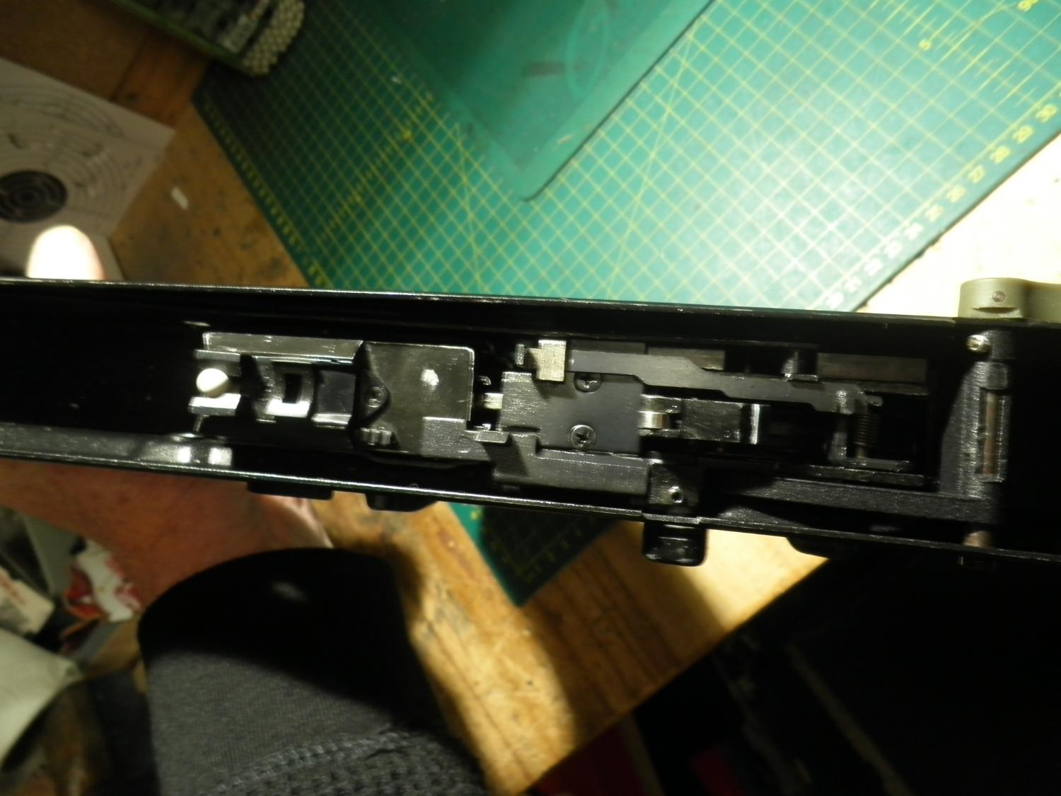

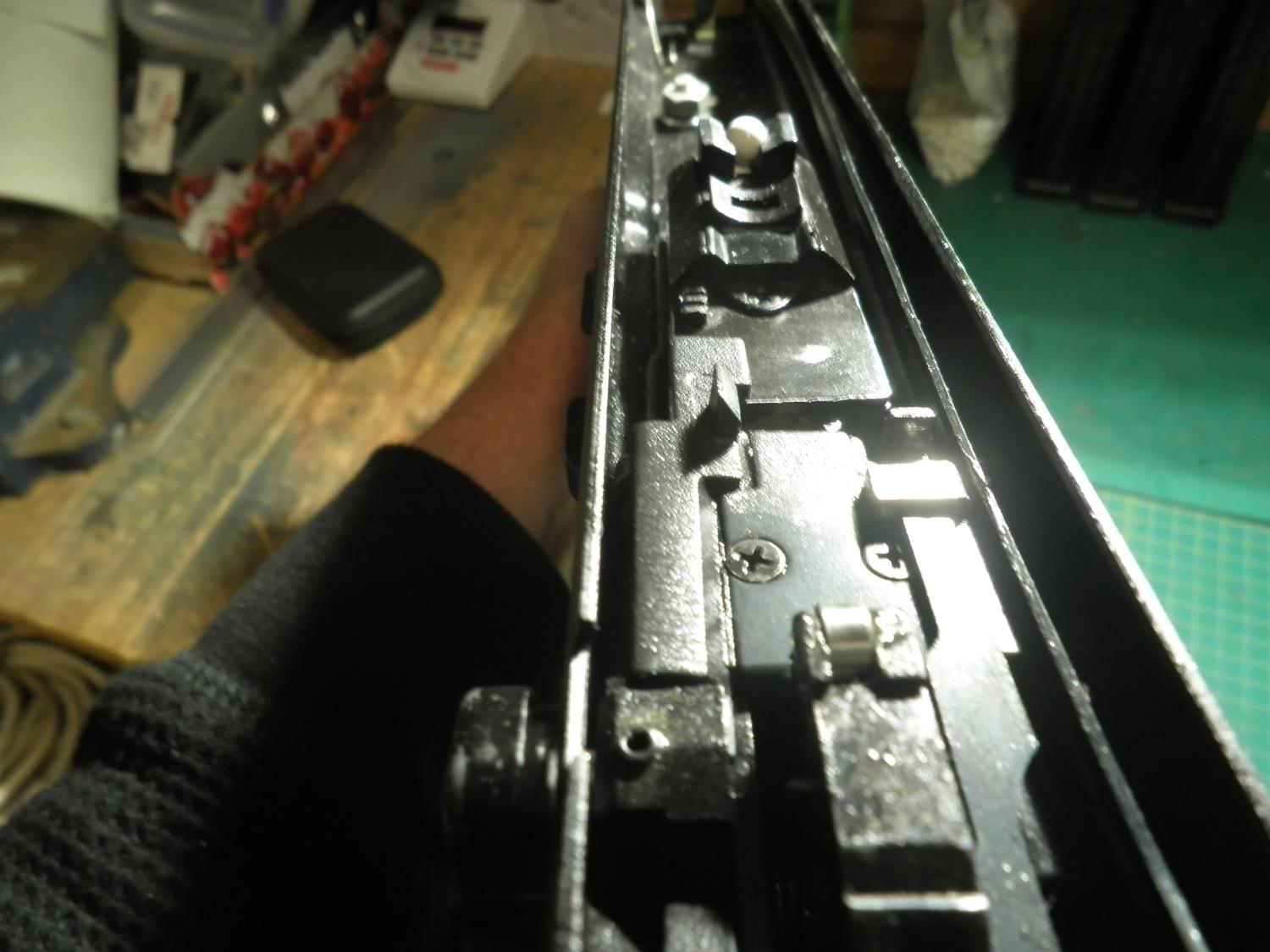

Nick G Posted April 16, 2024 Posted April 16, 2024 Couple of pics of mine with a loaded mag in, that's in the resting position sat on the mag catch.

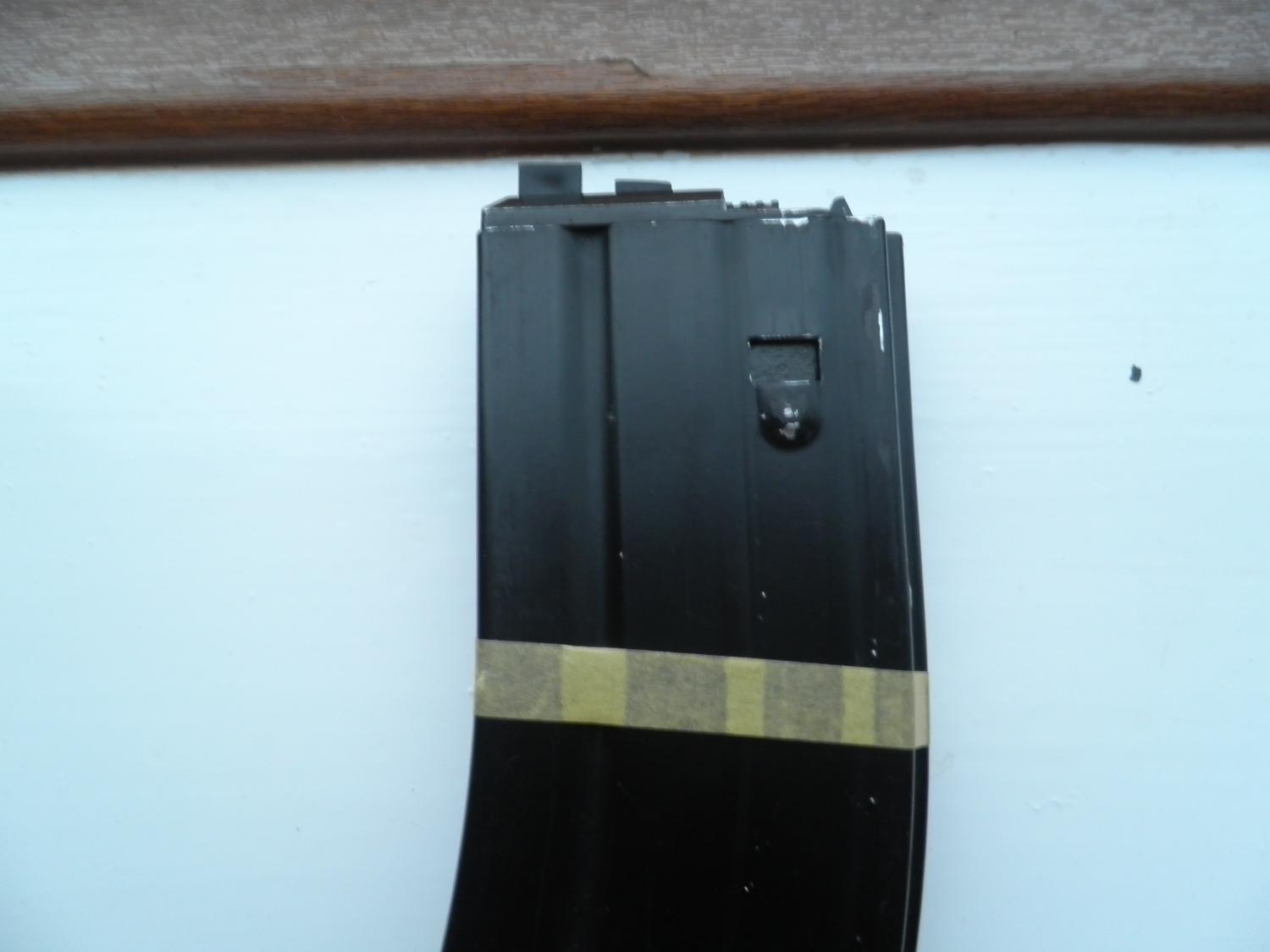

Guest JinxDuh Posted April 17, 2024 Posted April 17, 2024 Nozzle seems fine, will change the spring still as it sticks but can’t see any faults with the “arm” With the magazine in, the bolt catch twists at an angle both empty and loaded. The top of the blue tape is where the bottom of the mag well is lined up when the magazine is at the “correct” position, so there’s quite a drop. It’s roughly 0.5cm of difference. The video shows the movement better. IMG_5230.mov This is the “optimal” position for the tape, which locks the mag into the correct spot and lets it fire. A fix, but not ideal… Any ideas greatly appreciated ?

Guest JinxDuh Posted April 17, 2024 Posted April 17, 2024 54 minutes ago, gavinkempsell said: Is the mag catch straight? looks buckled in the pic. do you have another L85 you could swop this with to see if it helps? Mag catch seems okay in person, sadly I don’t have another to test. I did notice a scuff mark on the BB’s, like a small black line which is the same size as the nozzle arm so I’m assuming that’s a part of the problem. So far, I’ve taped all 3 mags and they all work and feed fine (And still fit/feed in my M16A1 ?), so I’m going to run it as is for the time being until either the mag catch fails or the nozzle and then replace both!
Nick G Posted April 17, 2024 Posted April 17, 2024 That's a significamt difference in height. The pictures with the mag in from above, is that with the mag 'lifted' or sat on the catch ? Nozzle prong certainly looks the same as mine. If you have the mag in the low position (sat on the catch) does the gun fire ok if an empty mag is set to dry fire ? If the valve knocker ries over the output valve rather than hits it that might point to a mag location issue which would suggest the mag catch.

Guest JinxDuh Posted April 17, 2024 Posted April 17, 2024 12 minutes ago, Nick G said: The pictures with the mag in from above, is that with the mag 'lifted' or sat on the catch ? It's with the mag lifted, yes. 13 minutes ago, Nick G said: does the gun fire ok if an empty mag is set to dry fire Yeah, it'll dry fire like it's cycling. I did also note that on empty it wouldn't lock back (It does on my m16), not sure if the L85 is designed to do so? 9 minutes ago, gavinkempsell said: does it wobble? Before the tape, yeah it had some play in every direction. Now it's solid ?
Nick G Posted April 17, 2024 Posted April 17, 2024 Yes the L85 should lock back on empty. Benning to look like the mag catch Top of the tape is where my magwell comes to , looks about the same as your 'lifted' mark. If the top tape is with thye mag sat on the catch I'd say your mag catch is buggered.
Guest JinxDuh Posted April 17, 2024 Posted April 17, 2024 1 hour ago, Nick G said: Yes the L85 should lock back on empty. Benning to look like the mag catch Top of the tape is where my magwell comes to , looks about the same as your 'lifted' mark. If the top tape is with thye mag sat on the catch I'd say your mag catch is buggered. Awesome. Well, not really… but at least I have a lead! ? Thank you so much guys for the help!!!
