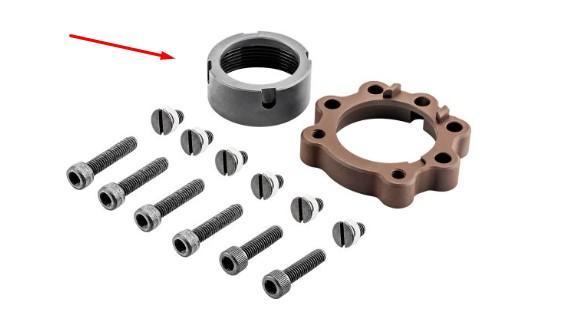

Matt.2504 Posted June 8, 2024 Posted June 8, 2024 How do I stop my mk18 mod 1 rail from wobbling side to side?
Matt.2504 Posted June 8, 2024 Author Posted June 8, 2024 Forgot to say; trying to attach it to a Cyma 097
Chev Chelios Posted June 8, 2024 Posted June 8, 2024 Is it a copy of this? https://danieldefense.com/mk18-risii-fde.html Without seeing it my first thought is to add some barrel shims before you torque the barrel nut. Example of barrel shims (don't buy them they are exorbitantly priced for what they are) https://www.fire-support.co.uk/product/angrygun-barrel-nut-shimswashers-includes-05mm-x-5pcs-and-1mm-x-5pcs If its not chuck us up a few photos.
Matt.2504 Posted June 8, 2024 Author Posted June 8, 2024 Yeah it’s that one; I’ll look into buying some shims - hopefully cheaper than the ones you linked. Thank you very much.
AlphaBear Posted June 9, 2024 Posted June 9, 2024 Try the sales forums and people used to sell them all the time!
Guest JinxDuh Posted June 9, 2024 Posted June 9, 2024 You can do the same thing with key rings too. It’s how I got my tippmann when I had it to accept a DD rail and not wobble!
