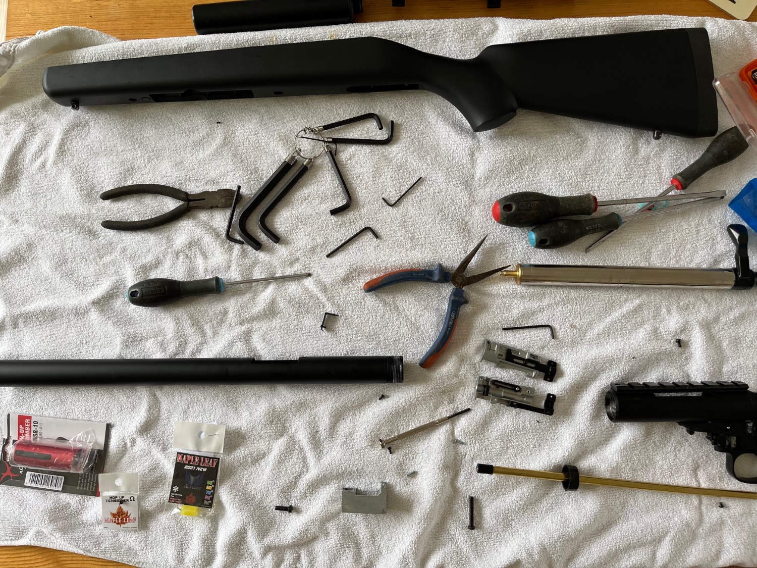

Reef Posted June 29, 2024 Author Posted June 29, 2024 23 hours ago, Speedy Sloth said: On a side note Mr hewes restoration of the fv4005 has been fun to watch, wish I could have gone tankfest this year. Met Mr Hewes today and spent 20min’s talking to him. He’s honestly a top bloke and exactly like he is on film. The FV4005 is an impressive bit of kit. As for the VSR, fitted the parts yesterday afternoon, was more fiddly than hard to do. The rifle works but yet to test it outside of the garden so don’t know if it’s made a difference. Thanks for all the advice? Rogerborg and Speedy Sloth 2
