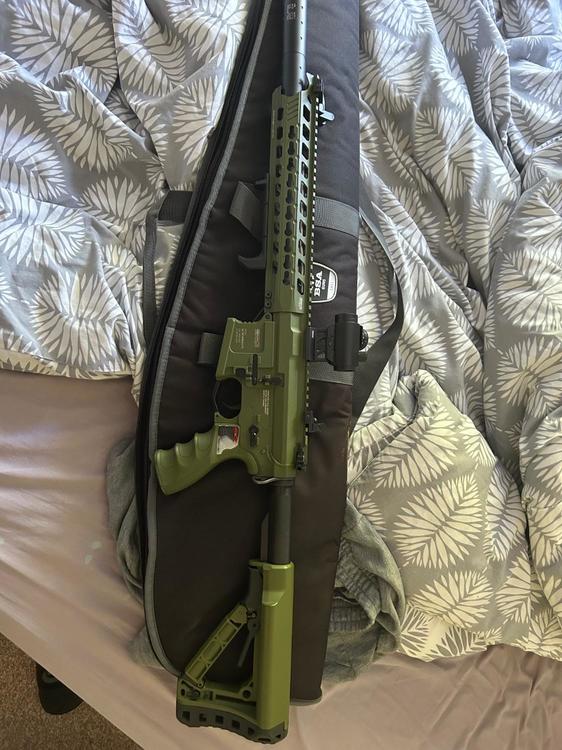

Burty99 Posted August 29, 2024 Posted August 29, 2024 Hi all, Relatively new to the hobby, I picked up a G&G armament GC intermediate a few months back. It shoots just fine but I know it can do better… I have had a good scan over these forums and noted that if you want to increase distance etc it’s usually the spring and hop up etc, is that the case? If so would anyone know which exact ones to go for? Or point me to a site/supplier that could help, I’m more than happy to tinker around with the gun myself but just didn’t want to order the wrong part and screw my internals up… Thanks all Jon
