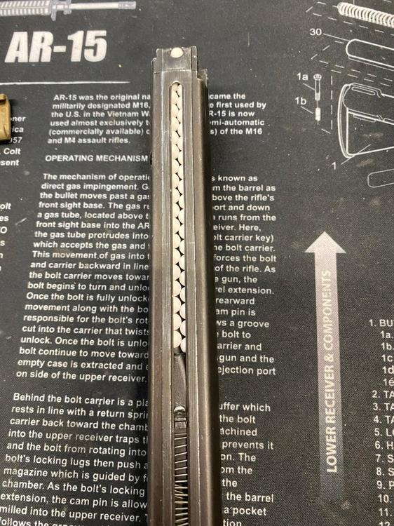

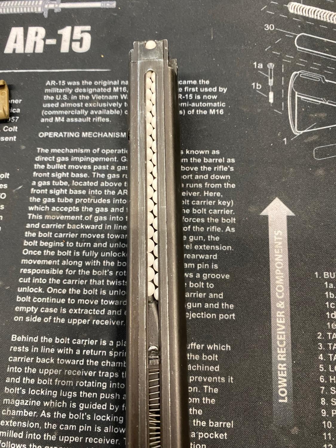

hitmanNo2 Posted October 25, 2024 Posted October 25, 2024 Are the mags loaded "properly" i.e. neatly double stacked? I seem to recall MP9s can be picky with feeding unless mags are loaded like this. Even down to which side of the follower is touching the first BB.
Guest JinxDuh Posted October 25, 2024 Posted October 25, 2024 Just now, hitmanNo2 said: Are the mags loaded "properly" i.e. neatly double stacked? I seem to recall MP9s can be picky with feeding unless mags are loaded like this. Even down to which side of the follower is touching the first BB. Yeah, I followed Jaeger Precisions video of loading the first bb on the left side, does the same all the way.
Guest JinxDuh Posted October 25, 2024 Posted October 25, 2024 Took a slow motion video and you can see the issue. The nozzle returns fine for the first few shots, and then the nozzle and bolt only “half move” IMG_6961.mov This is how the bb’s are stacked, with fresh green gas
