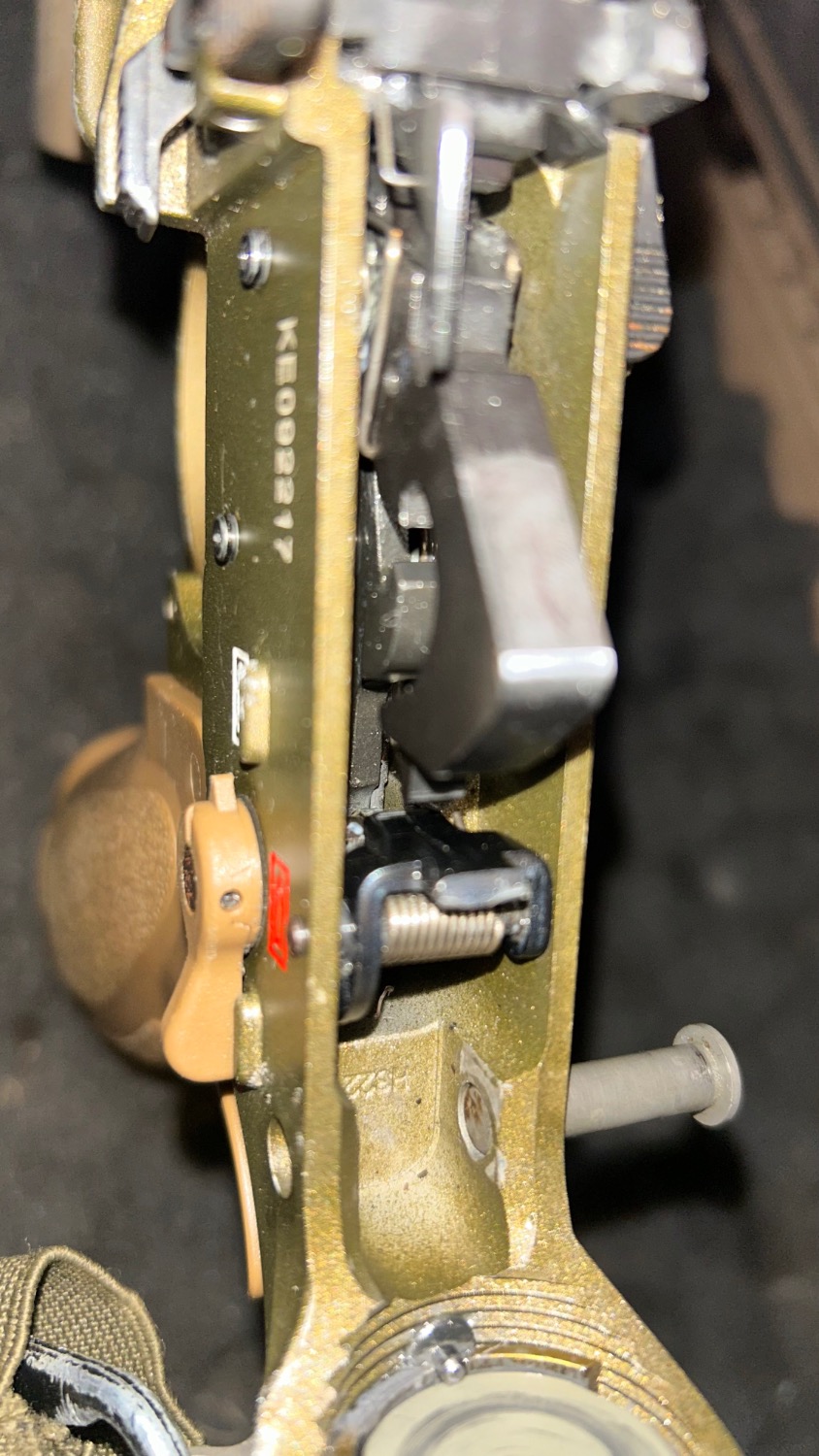

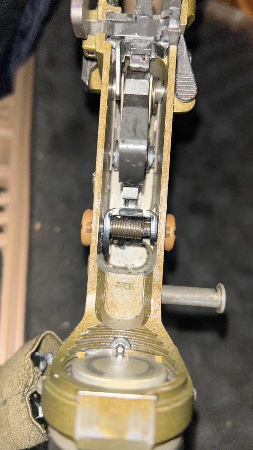

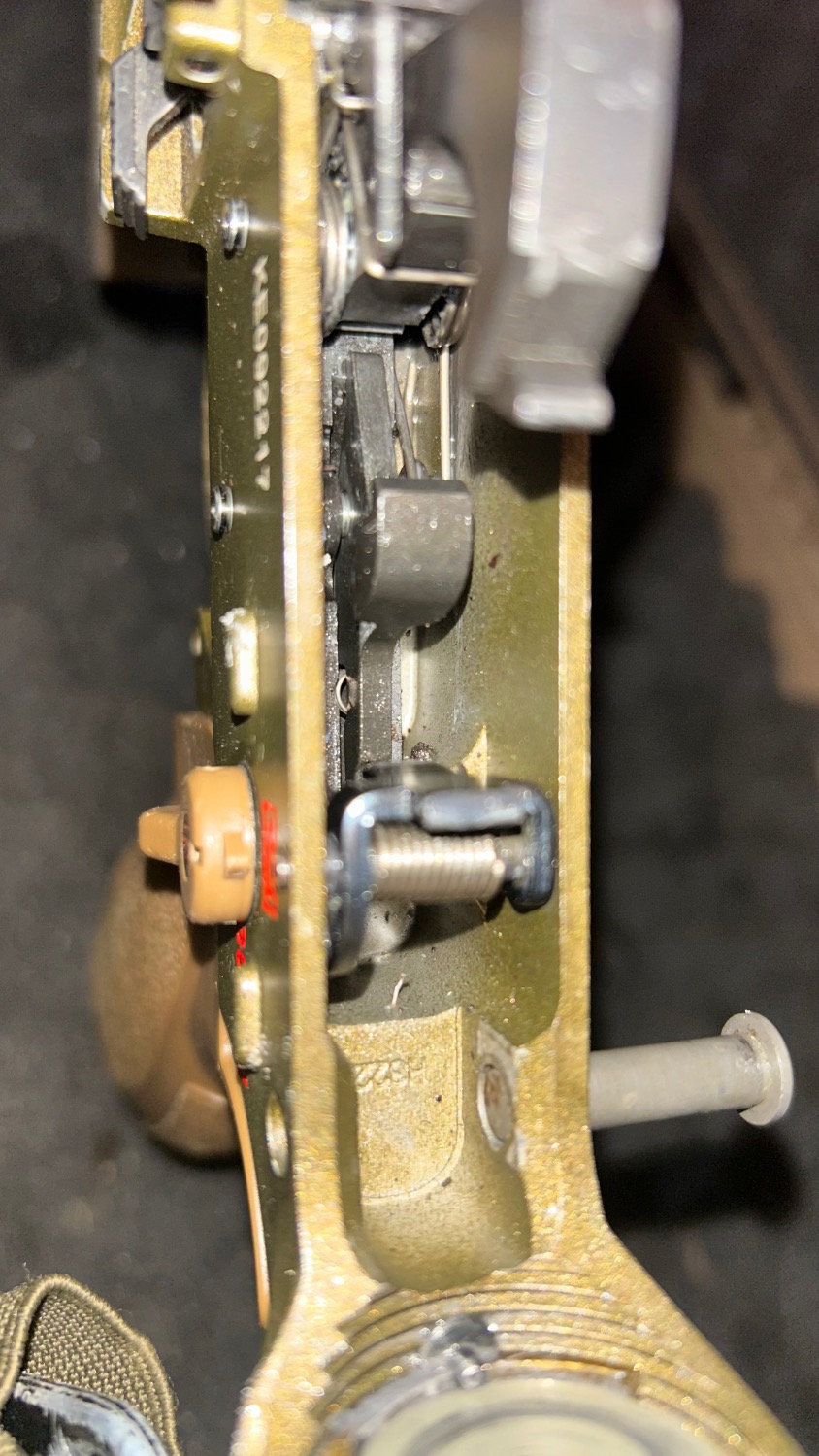

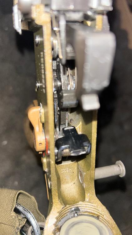

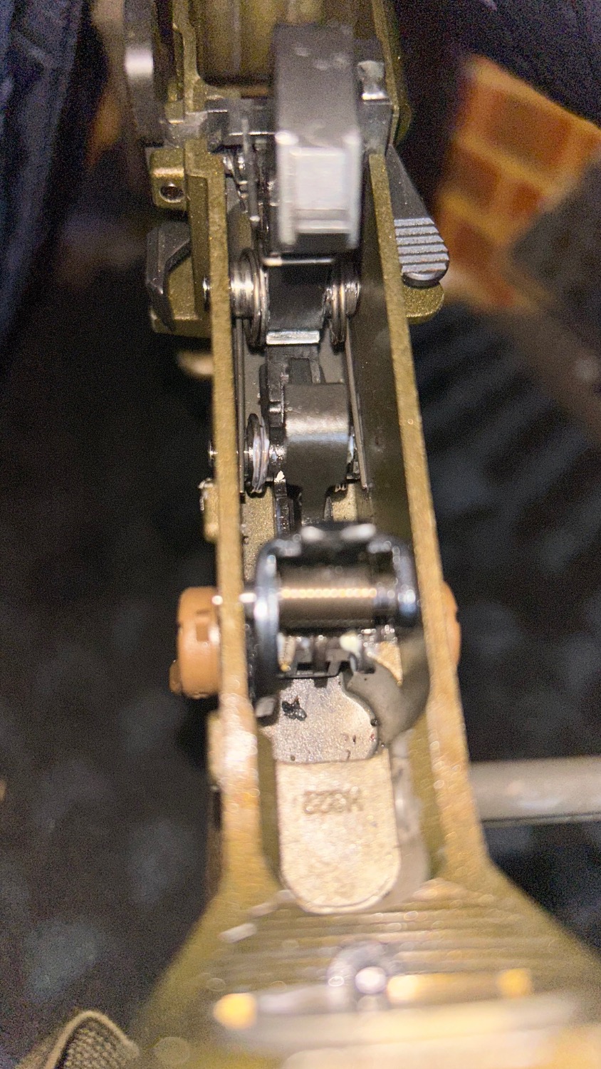

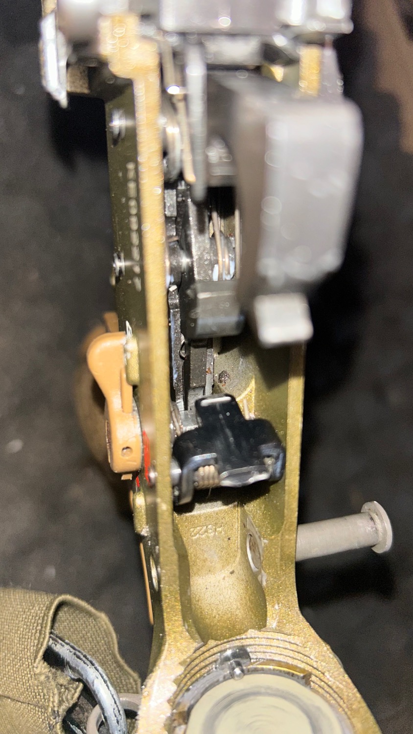

Gavthegat Posted December 12, 2024 Posted December 12, 2024 18 hours ago, BigStew said: A few of the parts are interchangeable so anything would help. Thanks. Hopefully these give you some reference. Fire selector is in a couple different positions. Fingers crossed you can spot something wrong! BigStew 1
BigStew Posted December 12, 2024 Author Posted December 12, 2024 52 minutes ago, Gavthegat said: Hopefully these give you some reference. Fire selector is in a couple different positions. Fingers crossed you can spot something wrong! A few difference but basically the same. I am not seeing anything different to the way I have reassemble mine. Oh well another try tonight. And maybe more parts ordered
