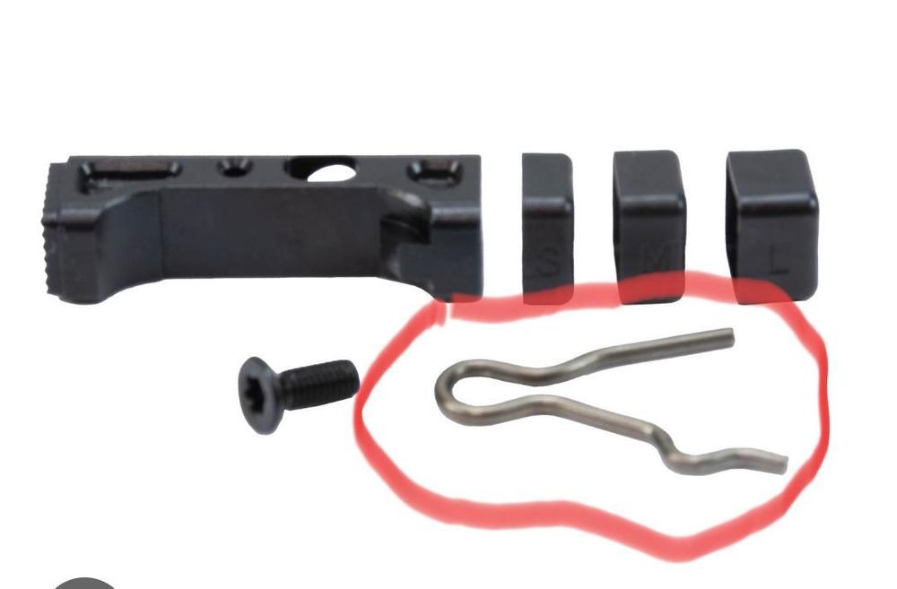

Robot666 Posted November 28, 2024 Author Posted November 28, 2024 The pin looks like this, so unfortunately a roll pin would be no good. Thanks any way chaps
Moderators Tackle Posted November 28, 2024 Moderators Posted November 28, 2024 2 hours ago, Robot666 said: The pin looks like this, so unfortunately a roll pin would be no good. Thanks any way chaps Bugger, that's a weird looking pin, only other thing I can think of that comes close would be a very small R clip, but you'd have to get busy with a couple of pairs of needle nose pliers to get the shape right.

Robot666 Posted November 28, 2024 Author Posted November 28, 2024 48 minutes ago, mightyjebus said: LCT HK53 uses a similar pin on the rear pin for the receiver. What length do you think it is and I'll check the LCT pin to see if it matches. I'd say it was 1 inch or so
mightyjebus Posted November 28, 2024 Posted November 28, 2024 The clip is part of the pin highlighted in re above. Might be easier finding an LCT than a Canik part. Failing that, buy a split pin and modify it to fit. Tackle and Robot666 1 1
Robot666 Posted November 28, 2024 Author Posted November 28, 2024 That would be perfect I reckon. Thanks buddy I'll try track one down. In the meantime time I'm gonna get my head torch on and scout the floor again for the bloody thing mightyjebus, DerDer and Tackle 3

Robot666 Posted November 28, 2024 Author Posted November 28, 2024 I've ordered a box of R clips I think I should be able to fashion one into what I need Tackle 1
