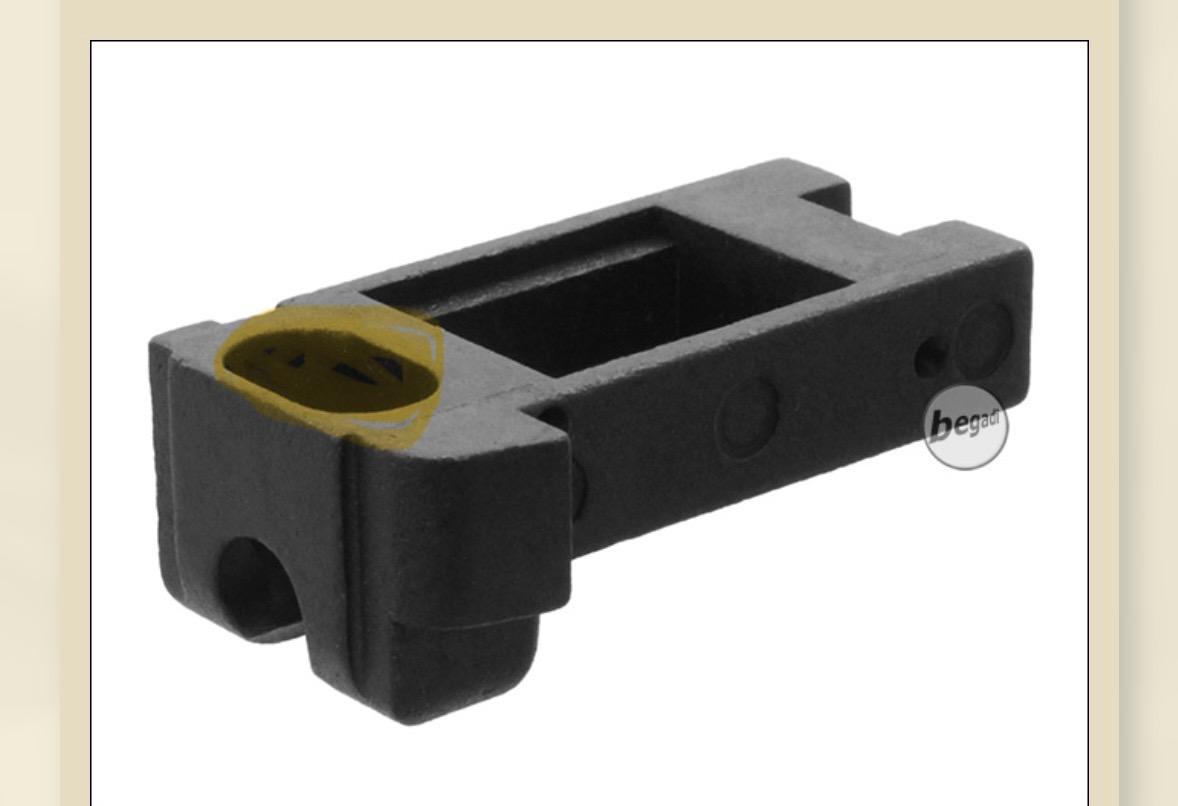

Ronin0033 Posted January 30 Posted January 30 Hey! The nozzle “sticking” won’t be the feed issue, that is just showing it’s got a good seal with the hop rubber. The bolt movement will ensure the nozzle comes free so don’t worry about that. For only feeding every other shot I’d check the mag feed lips first. I’ve found with certain mags and certain BB brands the BB can get caught on the part where the mag lip meets the mag. Remove the mag lip (2 pins) and gently file down the around the yellow highlighted parts to make sure its not sharp & has no burrs. Also do any sharp parts around the top of the lip while you are there, MP9’s can chew BB’s a little when loading due to the metal lips. If it’s still misfeeding after that I’d try a different brand of BB’s just to make sure. I found Excels tended to be slightly too small for the mag tract and would jam themselves up…. EvilMonkee and bigM 2
