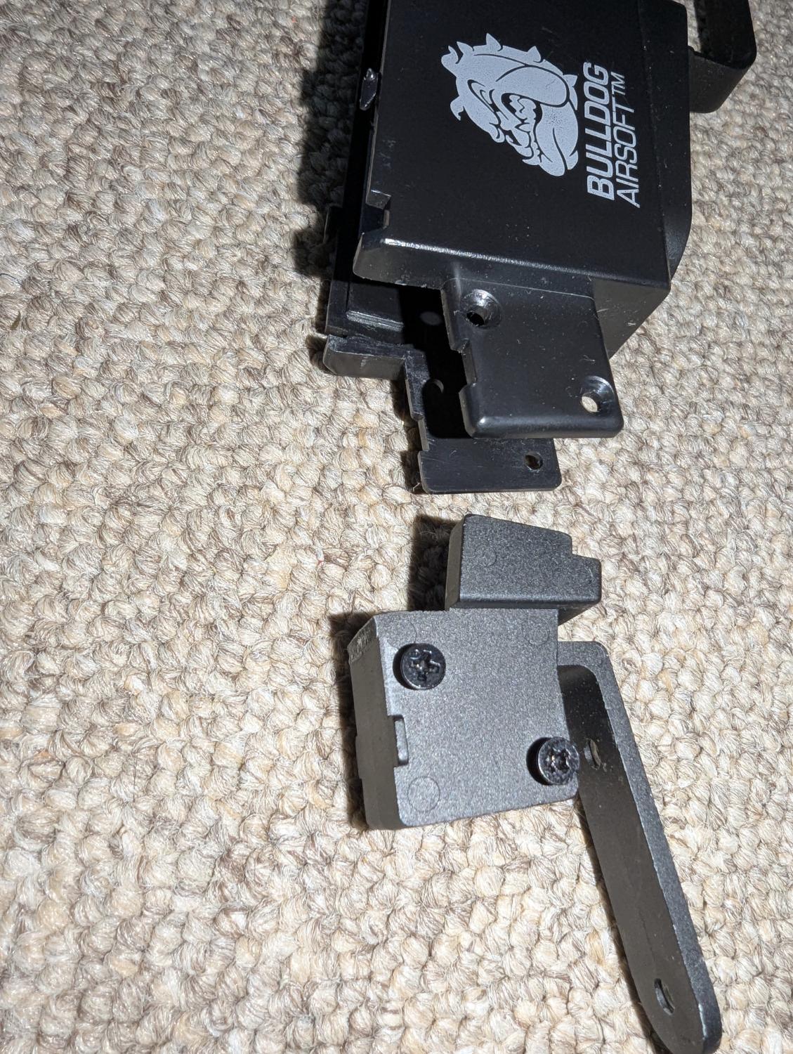

Holly Wallace Posted May 18 Posted May 18 Hiya all, The fixed stock mount (lower piece in img) on my Bulldog SRC SR-47 has recently karked it in an incident with a very stubborn countersunk hex screw. I've had a look around and haven't seen or heard much mention of AK stock mounting methods other than the typical folding hinge type, And I'm not sure if this reciever and stock mount is some proprietary deal or not (I have heard the SRC SR-47 is a CYMA clone). If anyone knows if this reciever will take other stock mounts (fixed or hinged works), And/Or where to find replacements, That'd be great. If more info is needed, Just scream at me in the comments. I probably missed a detail or two. Thanks
The_Lord_Poncho Posted May 19 Posted May 19 Looks to my like it is this part - sold for the Cyma CM028 (TM clone) fixed stock AK: https://www.18airsoft.com/products/cyma-cyma-ak-stock-metal-adapter-cy-0040 Lozart 1
Holly Wallace Posted May 19 Author Posted May 19 8 hours ago, The_Lord_Poncho said: Looks to my like it is this part - sold for the Cyma CM028 (TM clone) fixed stock AK: https://www.18airsoft.com/products/cyma-cyma-ak-stock-metal-adapter-cy-0040 Absolute lifesaver. Thanks!
