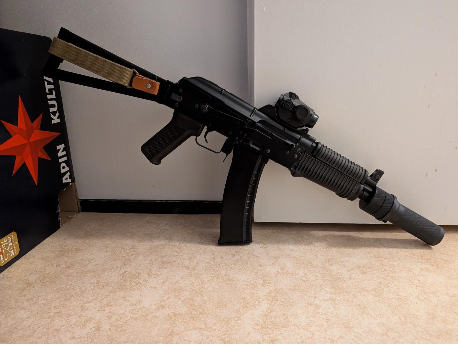

Konsta Posted August 5 Posted August 5 I recently bought a new Cyma CM045 for around 70£. So far I've done some preventative work (reshimmed and relubed everything, checked seals etc). All I changed was add an R hop and mosfet. The gun is very quiet now (around 82 decibels) even though its shooting 1.65 joules (local European limit is 1.7) Suppressor really makes this gun shine. Stock motor and gears give just under 20 rounds per second which is enough for me. Effective range is around 65-70 metres with 0.32g bbs. The sight rail is just a diy from left over rail that's bolted onto the dust cover. Overall a great replica that's highly durable and upgradeable PXL_20250805_145413873~2.mp4 ButcherBill 1

Konsta Posted October 25 Posted October 25 (edited) With 11.1 you should consiser adding a mosfet. A budget option would be HAL V3. Mine has run well but I decided to change gears to SHS 13:1 and change the motor can to SHS HT (strong magnets) and SHS pinion. The stock piston didn't like this and the teeth wore down quickly. Stock O ring didn't work well at sub 10°C (fps unstable between 380-410 fps). Changed to 23.8 mm and yields stable 425 fps at all temperatures. Now I have a full steel teeth piston. Also got a mini PBS-1 for the looks. PXL_20251024_121226179.mp4 Edited October 26 by Konsta
