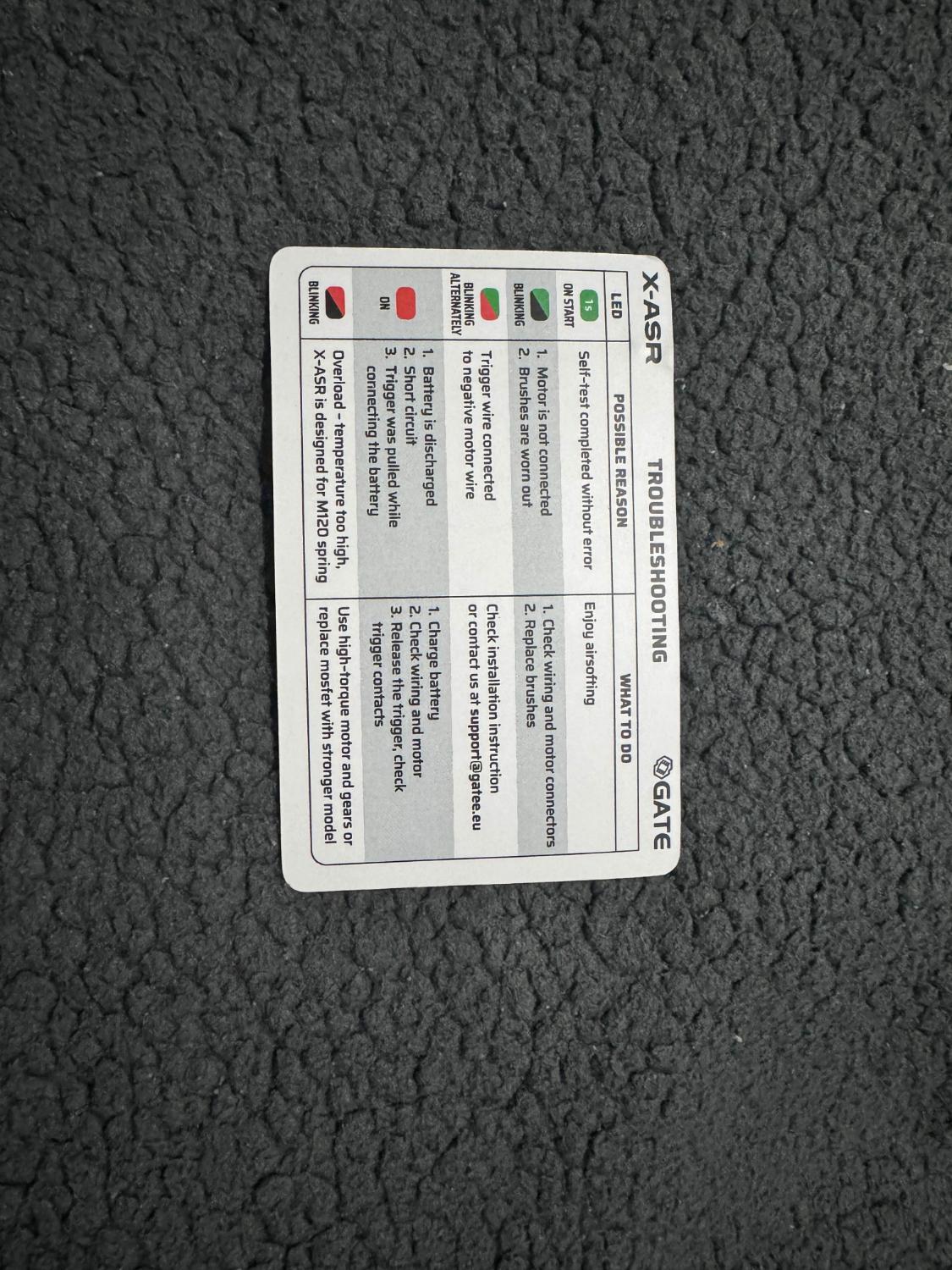

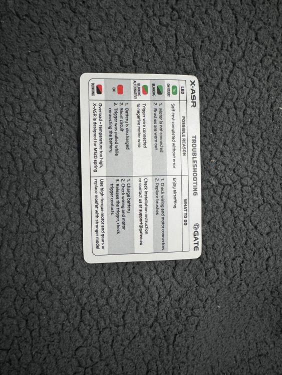

Alfie_0 Posted September 16 Posted September 16 Evening all, First time doing any tech work and have installed a new Solink 28k lite plus brushless motor and 13:1 gears into my specna edge. The old motor, when tested, works fine, spins freely even by hand etc. The new motor shows a solid red light on the x-asr mosfet and does not spin, will not spin freely by hand either, has a sort of regular interval clunk/click as you turn it. Not sure if that is normal or not. Have seen one post from a guy on reddit (https://www.reddit.com/r/airsoft/comments/nt5kt2/issue_motor_is_causing_a_supposed_short_circuit/) who seems to have a similar if not identical issue, which turnt out to be his mosfet, but of course that's only a single person on the internet so not taking it as gospel. Motor was recieved today brand new in box, with testing the old motor in same environment, those are the only two reasons I've found, either the motor is wankered or x-asr is being an arse Have linked youtube vids and a pic of the x-asr troubleshooting card for reference, not sure why one uploaded as a short sorry. https://youtu.be/Lft10NbVFYI https://youtube.com/shorts/EtoJwS5-LJg?feature=share Any advice much appreciated TIA, Alfie
Supporters Lozart Posted September 17 Supporters Posted September 17 12 hours ago, Alfie_0 said: The old motor, when tested, works fine, spins freely even by hand etc. The new motor shows a solid red light on the x-asr mosfet and does not spin, will not spin freely by hand either, has a sort of regular interval clunk/click as you turn it. Not sure if that is normal or not. How freely a motor spins is directly related to the strength of the magnets used to make it. If it spins freely then the magnets are weak and the motor will be shit. Ergo the Solink feeling clunky as it turns is, in fact, a sign of a better motor. Having changed the motors in a couple of Specna guns I can attest that they are, in fact, weak as shit. Also, the X-ASR MOSFET is rubbish. I also very much doubt the X-ASR can deal with a brushless motor. Fuck it off and put a decent unit in instead.
Alfie_0 Posted September 17 Author Posted September 17 34 minutes ago, Lozart said: Also, the X-ASR MOSFET is rubbish. I also very much doubt the X-ASR can deal with a brushless motor. Fuck it off and put a decent unit in instead. Cheers for the advice mate, will order a warfet and try throw that in, the x-asr has motor + and - as well as a blue wire from the trigger contact, all housed in the buffer tube. In theory I can just cut off the x-asr and put the warfet in its place no? Wiring seems to be the same?
Supporters Lozart Posted September 17 Supporters Posted September 17 30 minutes ago, Alfie_0 said: Cheers for the advice mate, will order a warfet and try throw that in, the x-asr has motor + and - as well as a blue wire from the trigger contact, all housed in the buffer tube. In theory I can just cut off the x-asr and put the warfet in its place no? Wiring seems to be the same? Personally, I'd skip the Warfet and go straight to an Aster. That said, I believe you can do what you are suggesting. The Aster choice is more based on the modern mosfets being better able to handle brushless motors than the older ones like the Warfet. ak2m4 1
Alfie_0 Posted September 17 Author Posted September 17 1 hour ago, Lozart said: Personally, I'd skip the Warfet and go straight to an Aster. That said, I believe you can do what you are suggesting. The Aster choice is more based on the modern mosfets being better able to handle brushless motors than the older ones like the Warfet. Yeah, after some research went for the Aster II with the Bluetooth starting to think maybe I should have just left my aeg alone… lol Lozart 1
Alfie_0 Posted September 18 Author Posted September 18 On 17/09/2025 at 10:56, Lozart said: Personally, I'd skip the Warfet and go straight to an Aster. That said, I believe you can do what you are suggesting. The Aster choice is more based on the modern mosfets being better able to handle brushless motors than the older ones like the Warfet. https://youtube.com/shorts/-7cqHl5aJo4 Aster II has done the trick ! Appreciate your help mate, much appreciated. Side note; how does my shimming sound? first time shimming
