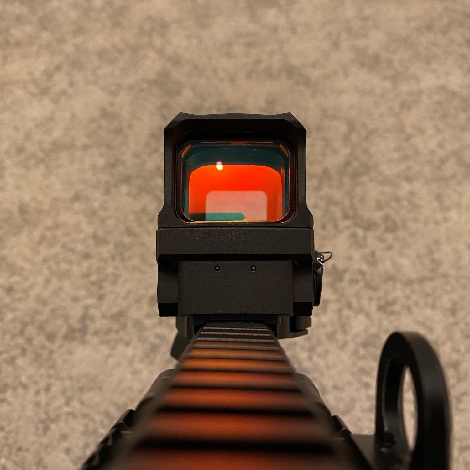

Gunboat Diplomat Posted September 19 Posted September 19 (edited) My woeful knock off UH-1 does not sit level on the rail of any of the three guns I’ve fitted it too. Mini review: £52 from AliExpress, don’t bother, it’s shit. As you can see, it’s canted over once the QR is clamped shut. Not amount of adjusting the QR or shifting it around on the rail stops it. I’ve ordered some foil tape to try and add some thin strips to the offside to try and level it out, but any other suggestions? Is there some basic of QR rail mounts I’m missing here? Edited September 19 by Gunboat Diplomat HZR13 1

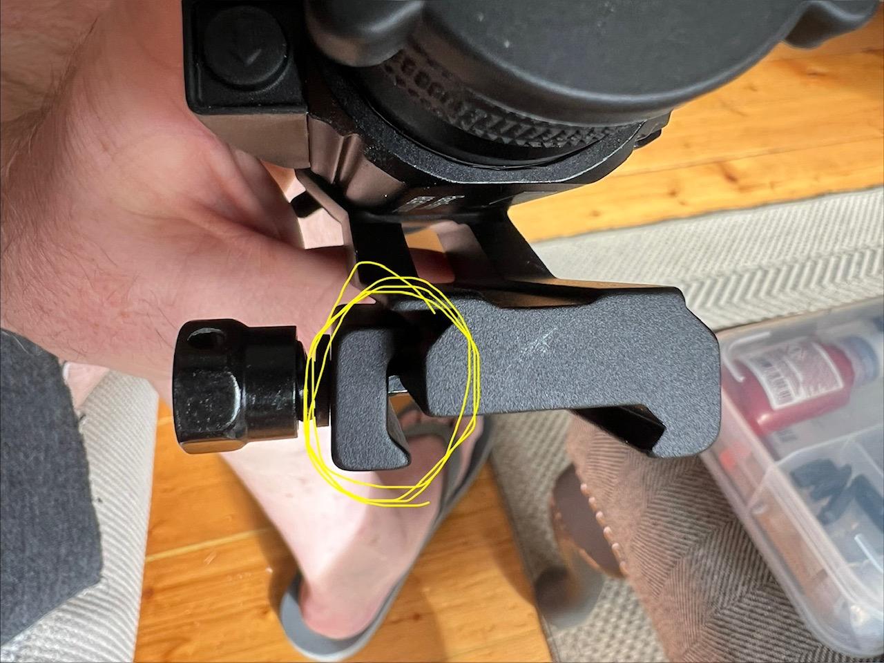

Enid_Puceflange Posted September 19 Posted September 19 Does it have the clamp style fitting for the pic rail? The “female” side that the securing bolt goes through may be upside down, causing it to not sit properly on both the optics body and the pic rail Ive sorted that on a few of mine when they arrived, just by turning it 180deg to correct its locating Lozart and ButcherBill 2
Enid_Puceflange Posted September 20 Posted September 20 This part could possibly be the culprit Try turning it 180 deg Gunboat Diplomat 1

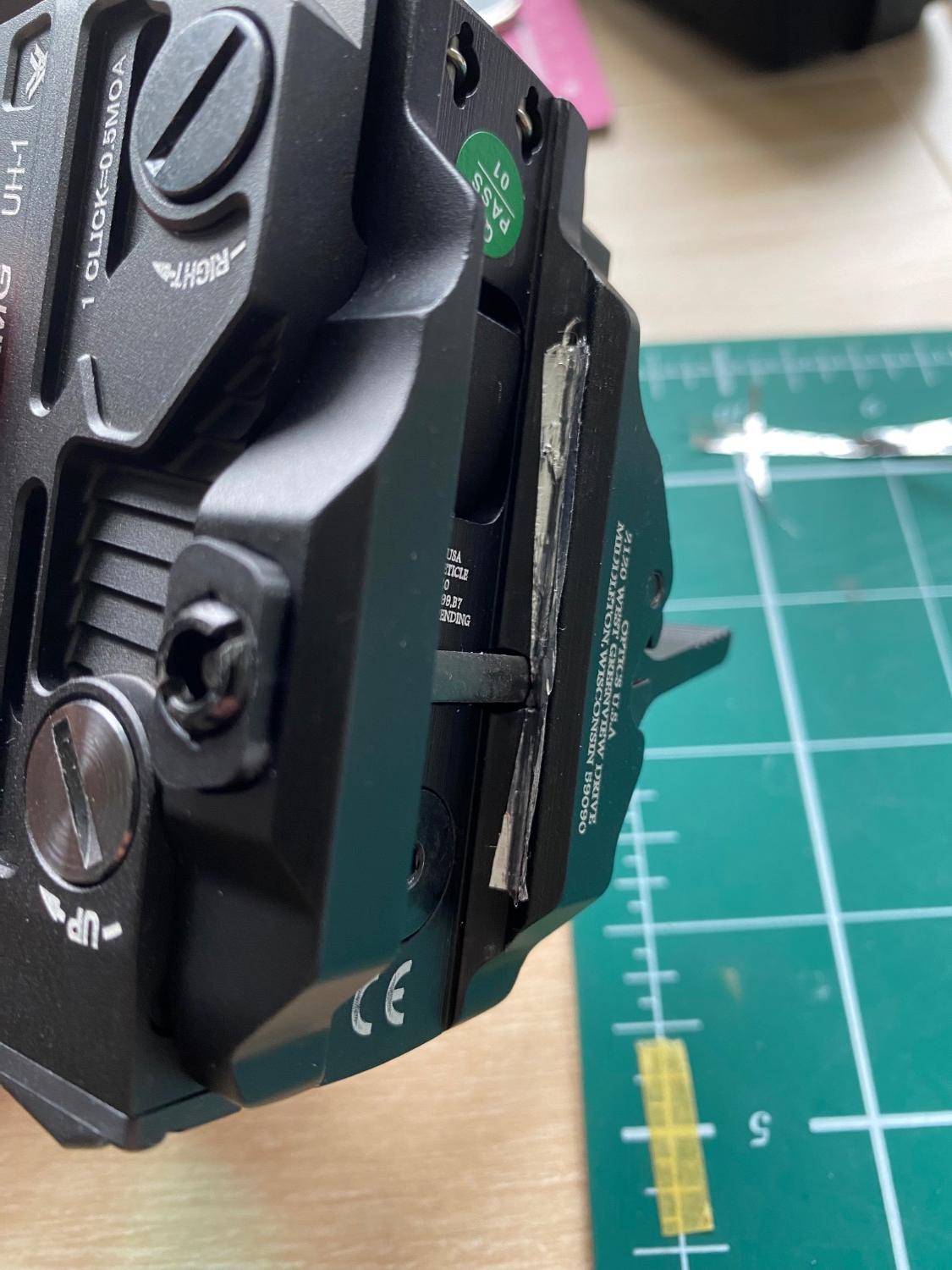

Gunboat Diplomat Posted September 20 Author Posted September 20 (edited) 5 hours ago, Enid_Puceflange said: This part could possibly be the culprit Ta, in my case it uses a crammed QR mount (the cam is the right way round so no mileage in flipping it in this case) After shimming it with about a dozen layers of foil tape, it is now pretty much level. Edited September 20 by Gunboat Diplomat Enid_Puceflange 1

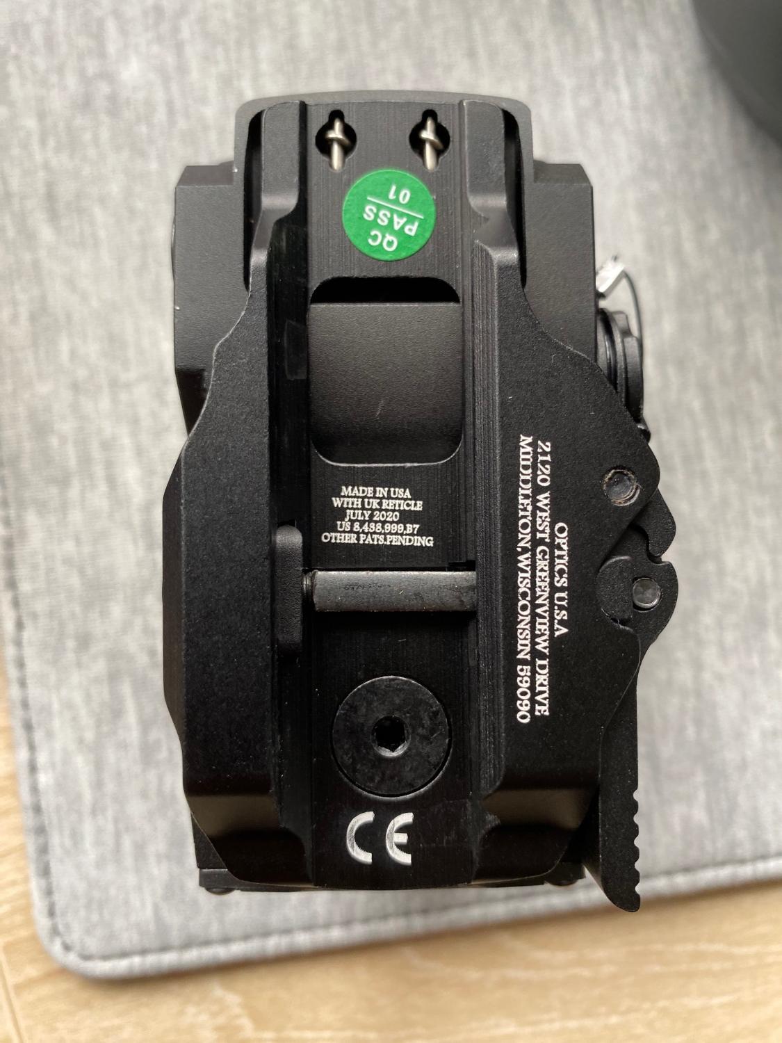

ButcherBill Posted September 20 Posted September 20 Just a thought but the pin is possibly upside down & might be the issue if it's not sitting in the rail space.
